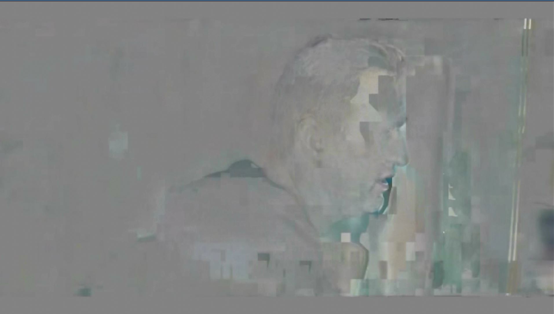

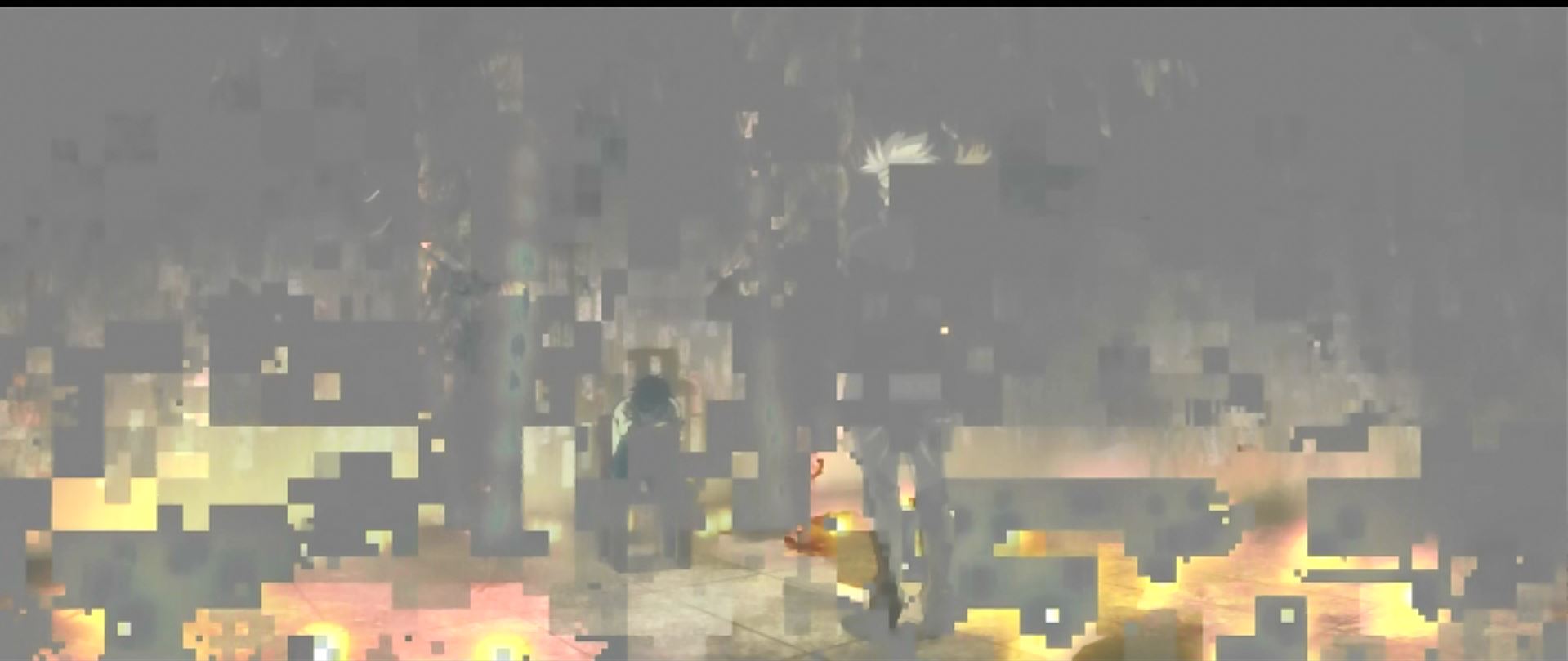

Resulting VIDEO_TS files are badly pixelated. See attached images. The app has been working very well with no problems but suddenly it has rendered 2 movies in a row with grayness and pixelation. I assumed the first one was because there was something wrong with the original file (although it looked fine playing on VLC) but now a second movie has come out with the same problem. I have not changed any settings in ConvertX. Is it possible to tell from the attached images what has gone wrong and what I need to do to get ConvertX to work properly again?

Posts: 6349
Re: Resulting VIDEO_TS files badly pixelated.
Those look like way too compressed, what is total filesize?
Or better, post conversion log please.

Are these pixelated VIDEO_TS results played when you open VIDEO_TS.IFO from a hard drive or when you play a DVD disc you've burned the VIDEO_TS to? If it's a disc, it could be a poor playback compatibility with lower quality media, if you're using that.

Original file is an MKV Video File and is 2,574,437 KB. It's not a DVD issue. The pixelated video is what I see when I go to the VIDEO_TS folder and play one of the files in VLC. Here is the log file:

RonWall,
Your video file has h265 codec, unfortunately ConvertX programs don't support this codec yet.
We are working on adding it.
VSO Support Team
