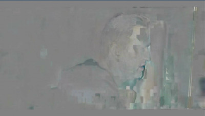

Resulting VIDEO_TS files are badly pixelated. See attached images. The app has been working very well with no problems but suddenly it has rendered 2 movies in a row with grayness and pixelation. I assumed the first one was because there was something wrong with the original file (although it looked fine playing on VLC) but now a second movie has come out with the same problem. I have not changed any settings in ConvertX. Is it possible to tell from the attached images what has gone wrong and what I need to do to get ConvertX to work properly again?

Those look like way too compressed, what is total filesize?
Or better, post conversion log please.

Original file is an MKV Video File and is 2,574,437 KB. It's not a DVD issue. The pixelated video is what I see when I go to the VIDEO_TS folder and play one of the files in VLC. Here is the log file:

RonWall,
Your video file has h265 codec, unfortunately ConvertX programs don't support this codec yet.
We are working on adding it.
VSO Support Team

In the meantime, try this. Install a piece of freeware called AVIDeMux. Load this input file you're having pixelation on it and save it with a different Video codec. Don't use Copy. Try x264. Those seem to work for me. Save the resulting output file, which given it appears to be a Blu-Ray rip of about 2 GB will probably take some time to convert. Then, try that new output file and see if it results in pixelation again.

dbminter, I followed the procedure you detailed and it worked fine with one of the two problem movies. Thank you so much.
I converted the other film with AVIDeMux in the same way but when I put it into ConvertX it resulted in a VTS file that was only about 3 minutes long so no joy there. Not a problem. I was able to find a different copy of that movie which worked fine with ConvertX.
