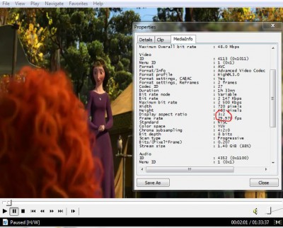

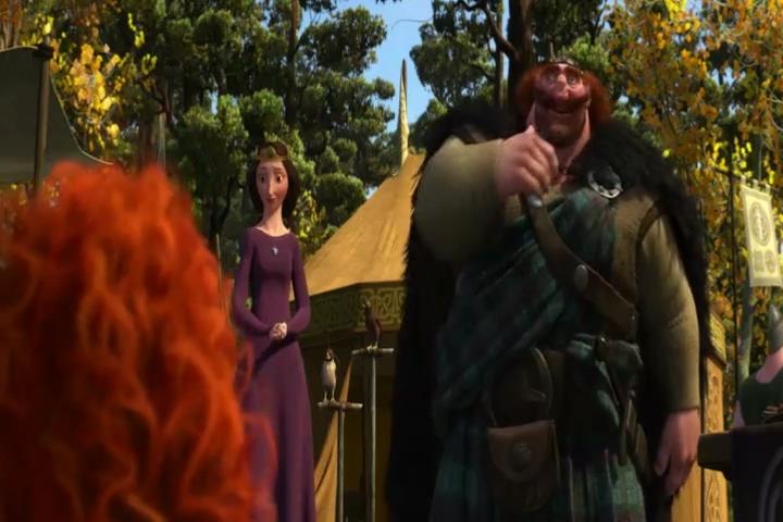

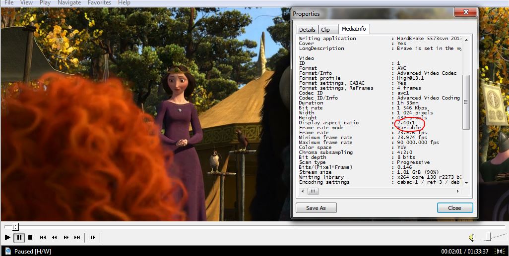

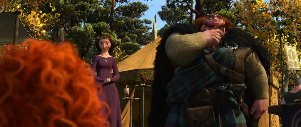

I used VC to convert a 1280x720 1:2.40 ratio movie to a 480p movie.. I'm testing putting multiple movies on a blu ray disc for use in a car / plane scenario etc. The resultant MTS image size was correct @ 720x480 but the image within that frame seem squashed horizontally and media info says ratio is 3:2. I would have expected it to be letter-boxed within the frame.
Attached before and after images as well as log and shots of the media info.
Maybe I'm wrong... but when I try the disc in a player even if I manually override the aspect ratio and set it to 16:9 it still looks a bit squashed.

Output frame media info says 3:2
Output frame 720 x480 Squashed horizontally?
Original frame media info
Orginal Frame 1280x720 @ 16:9

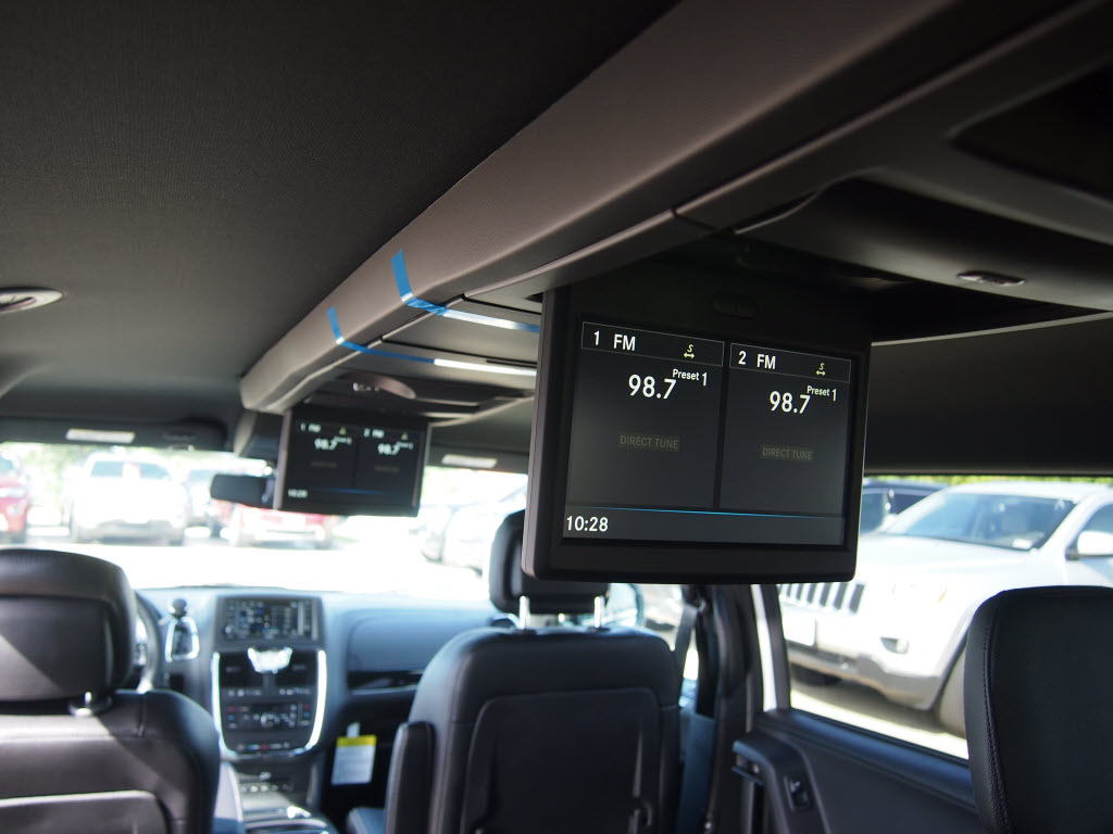

I was expecting letter boxing but then they'd know the specification better then me.. might be that anamorphic is correct (and best solution for DVDs and old skool widescreen TVs). Maybe I have to find the correct setting on the blu ray player in the car or maybe the cars screens are an odd aspect ratio and they need to do the letter boxing themselves....
~Steph
Screens in car
Screens in car
