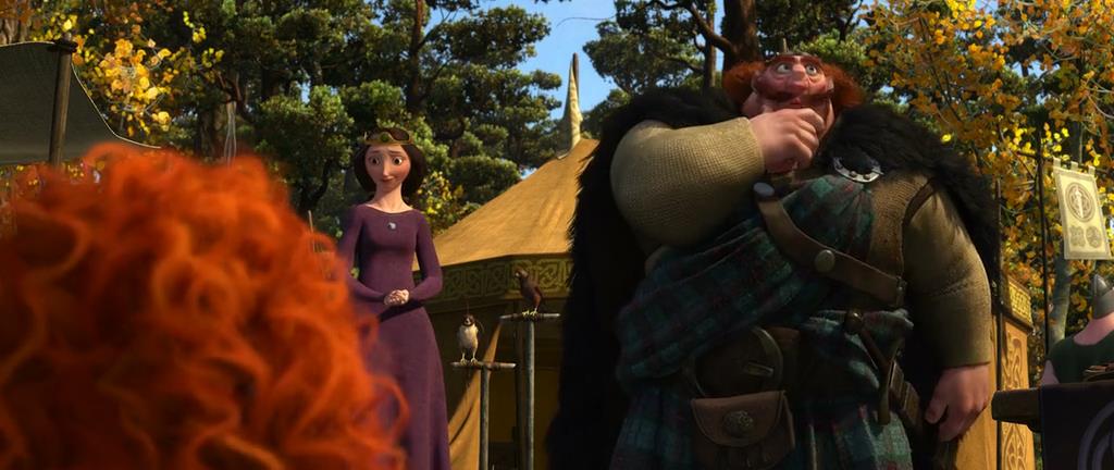

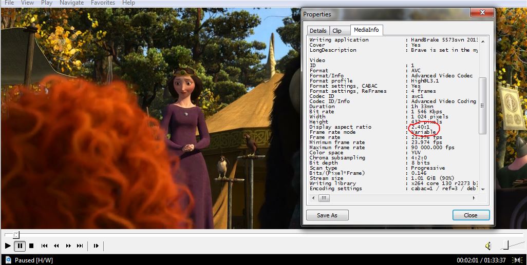

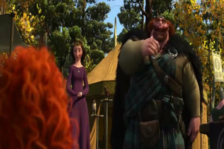

I used VC to convert a 1280x720 1:2.40 ratio movie to a 480p movie.. I'm testing putting multiple movies on a blu ray disc for use in a car / plane scenario etc. The resultant MTS image size was correct @ 720x480 but the image within that frame seem squashed horizontally and media info says ratio is 3:2. I would have expected it to be letter-boxed within the frame.
Attached before and after images as well as log and shots of the media info.
Maybe I'm wrong... but when I try the disc in a player even if I manually override the aspect ratio and set it to 16:9 it still looks a bit squashed.
Reminds of the old anamorphic format; maybe that was the intention and I need to find the right setting on the player to compensate...

It seems that when converting to 720x480 conversion is not going correctly;
DVD standard allows only anamorphic widescreen so conversion has to be done to anamorphic.
If it is not, then problems like this can occur.
VSO needs to check this more.

If you used automatic settings then it should be correct, but if you manually changed AR then it is a different issue.
Re: Possible Aspect Ratio Issue
Thanks!
I used automatic because the input files have different ratios so I wanted the software to do the calcs... I've tried doing one file and selecting letterbox too but performed the same. Its possible this is correct because it seems the blu-ray have these 480/576 modes borrowed from DVD where it does say WS can be anamorphic, it might be that the resultant aspect ratio reported by the file (3:2) is wrong and this should just be 4:3, maybe the player is reading the 3:2 and trying to do that.
Steph
Steph
I confirm there is a bug and have reported it here
http://bugs.vso-software.fr/view.php?id=7651
This problem should be corrected in the new beta version
http://forums.vso-software.fr/latest-be ... 17957.html
Can you confirm?

Did a test render last night with a full disc of titles in different aspect ratios.
The aspect ratio for each resultant file looks correct now on the non-widescreen 480P and 576p modes!
Haven't burnt a disc yet I just played the files but I think thats done it.
