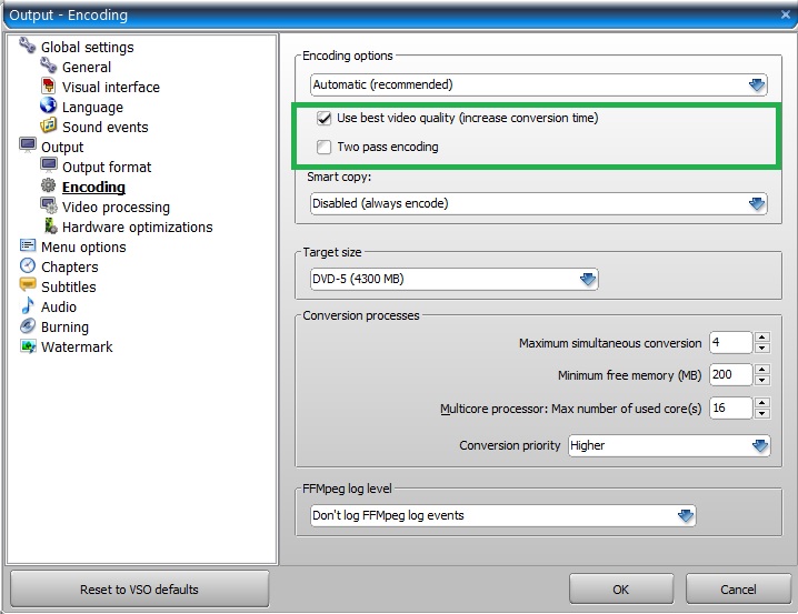

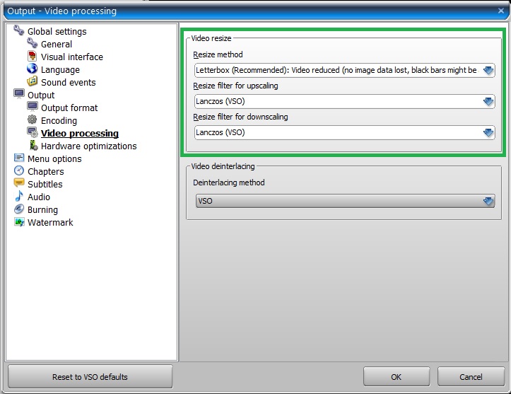

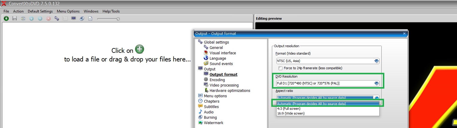

As for the output, I personally use “Full D1” and Letterbox
In theory 1080 and 2160p output should look the same…
I use [x] Encode with high quality (or something like this lol
If quality is something you are looking for, yes if will be much longer but encode using [x] 2 pass.
Lanczos (VSO) filters were suggested to me, as being the best choice years ago, so I always use these ones...
See what settings I personally use...
