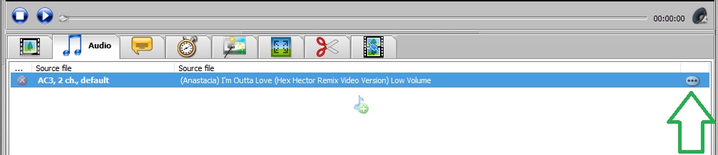

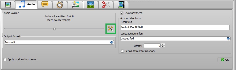

Please find the Audio Parsing button here:
