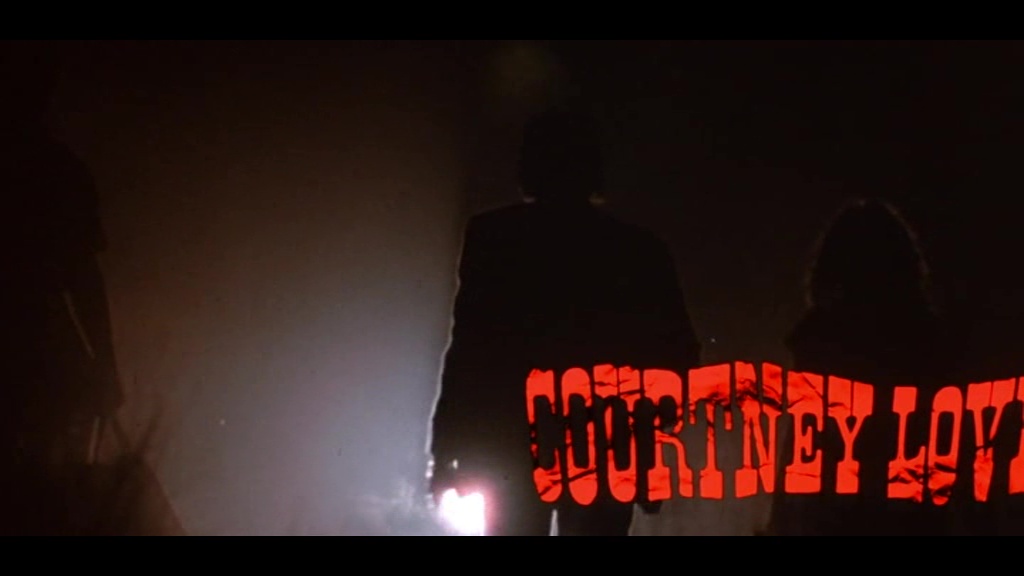

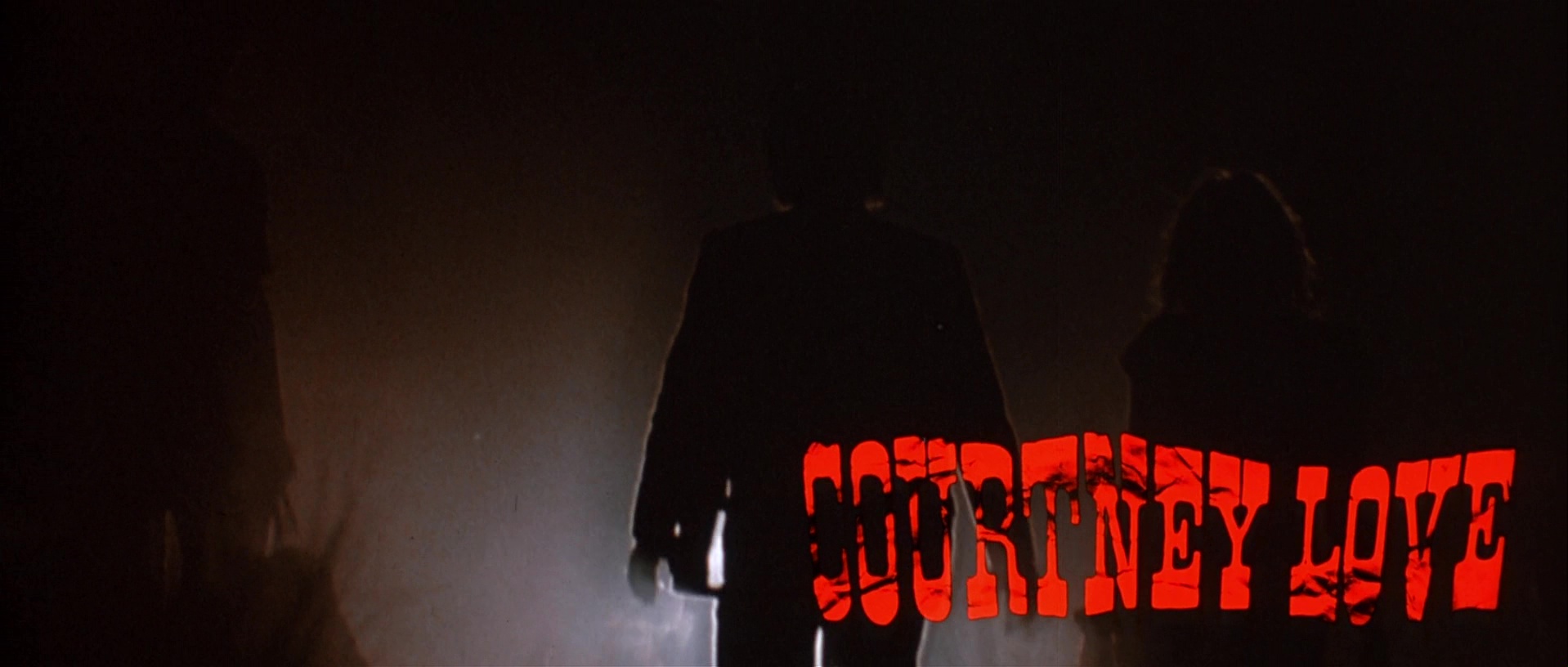

Hello.
The program seems to crop a bit the image so it is cut in both sides, please see a picture of the full image and another of how ConvertXtoDVD records it.
Is it me that I'm doing it wrong?
Thanks in advance!
Anaïs

Re: Format 1,85:1.
Post by Anaïs »
http://download.vso-software.fr/archive ... 0.0.73.exe
Tell me how it goes!

slumpillo
Posts: 3
Joined: Sat Mar 13, 2021 7:11 pm
Re: Format 1,85:1.
Post by slumpillo »
Yes! This version works fine, thanks a lot!
