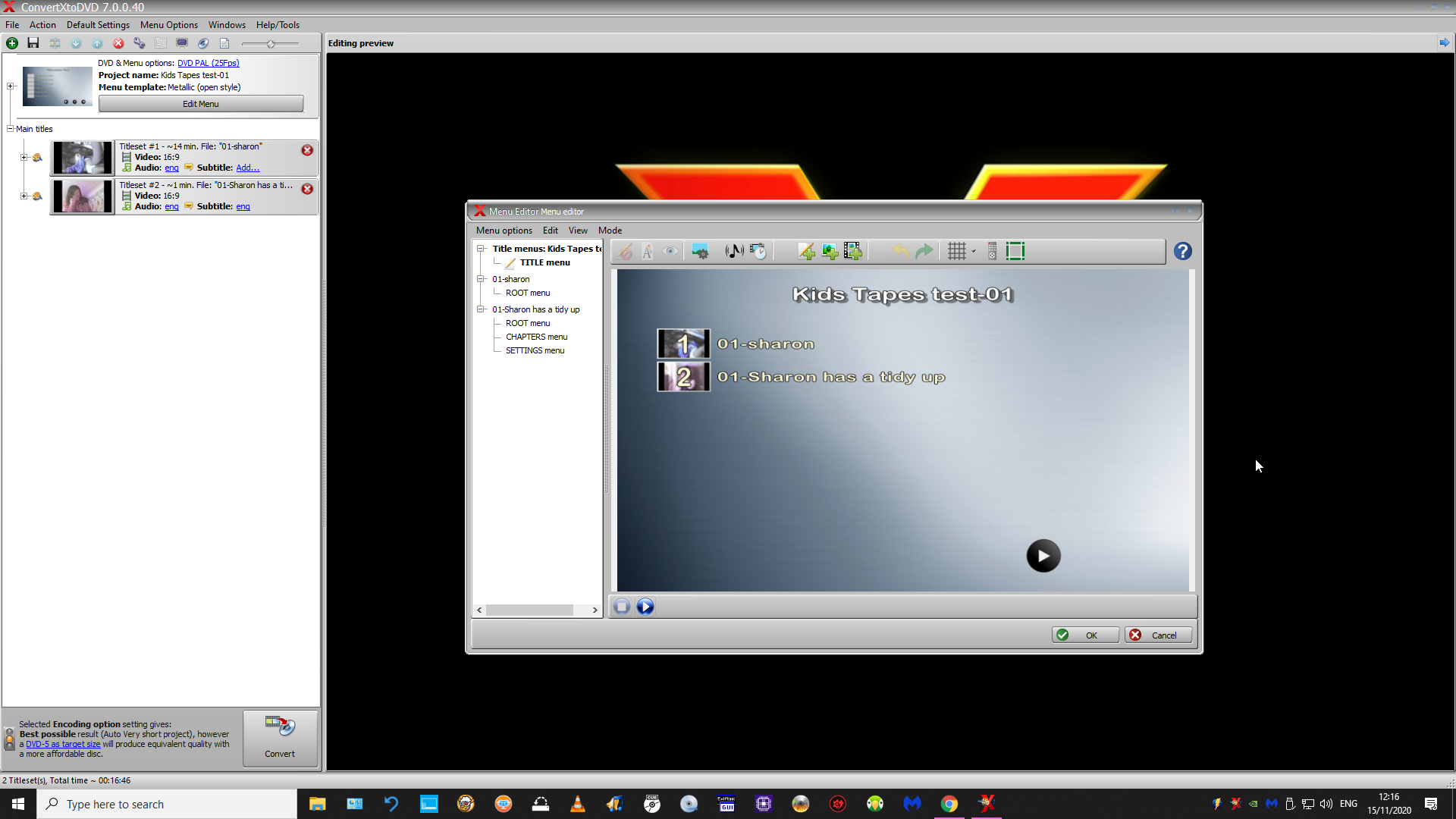

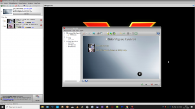

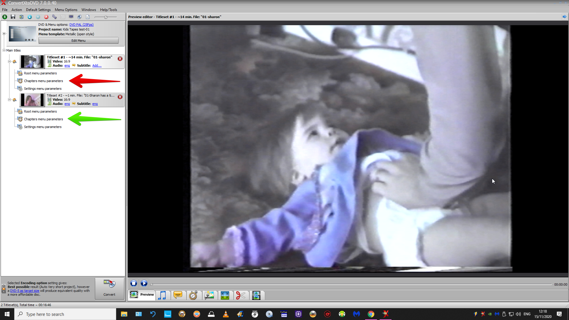

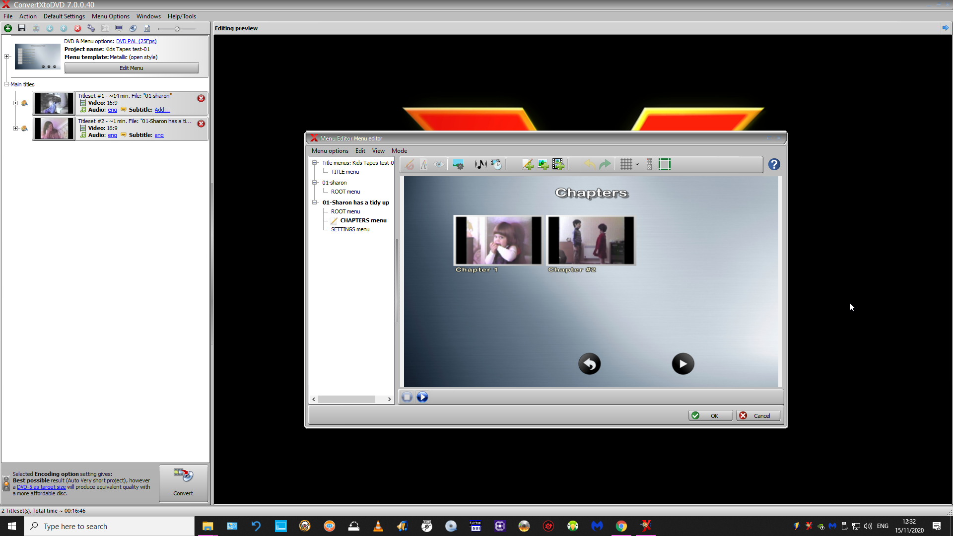

here are some screenshots to highlight my problem
the Title with the green arrow allows me to click on Root, Chapter or settings menu, The red arrow title only allows me to click on the Root menu.....not sure exactly what's going on, but all I want to do is
go from selecting one of these
to the chapter menu to chose one to play

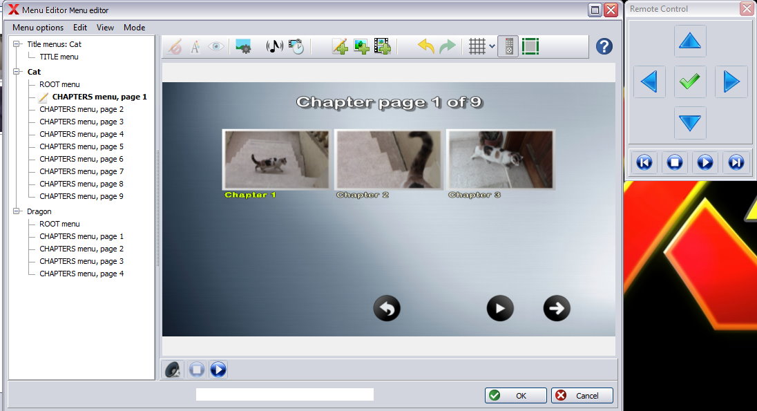

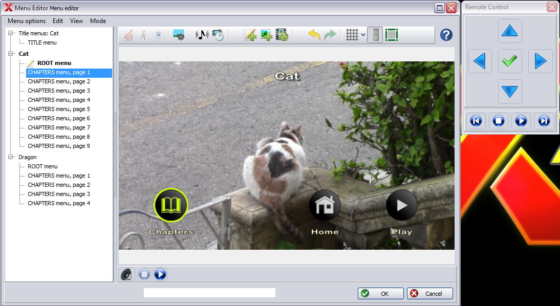

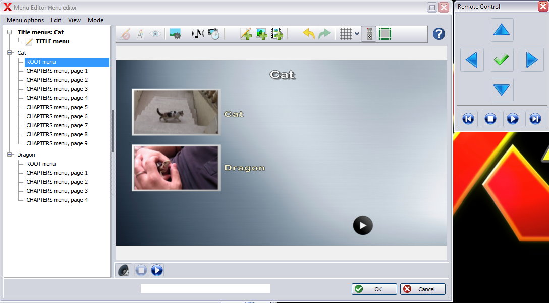

It is possible that from the title to go to the chapter page. Once you click on the selected title, you should be taken to the title options which includes the chapters button.
Clicking on the chapters button will take you to the first chapter page.
Use the other buttons to navigate or play the title.

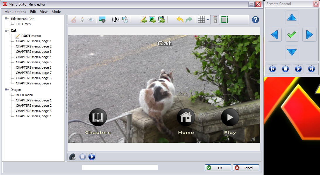

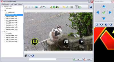

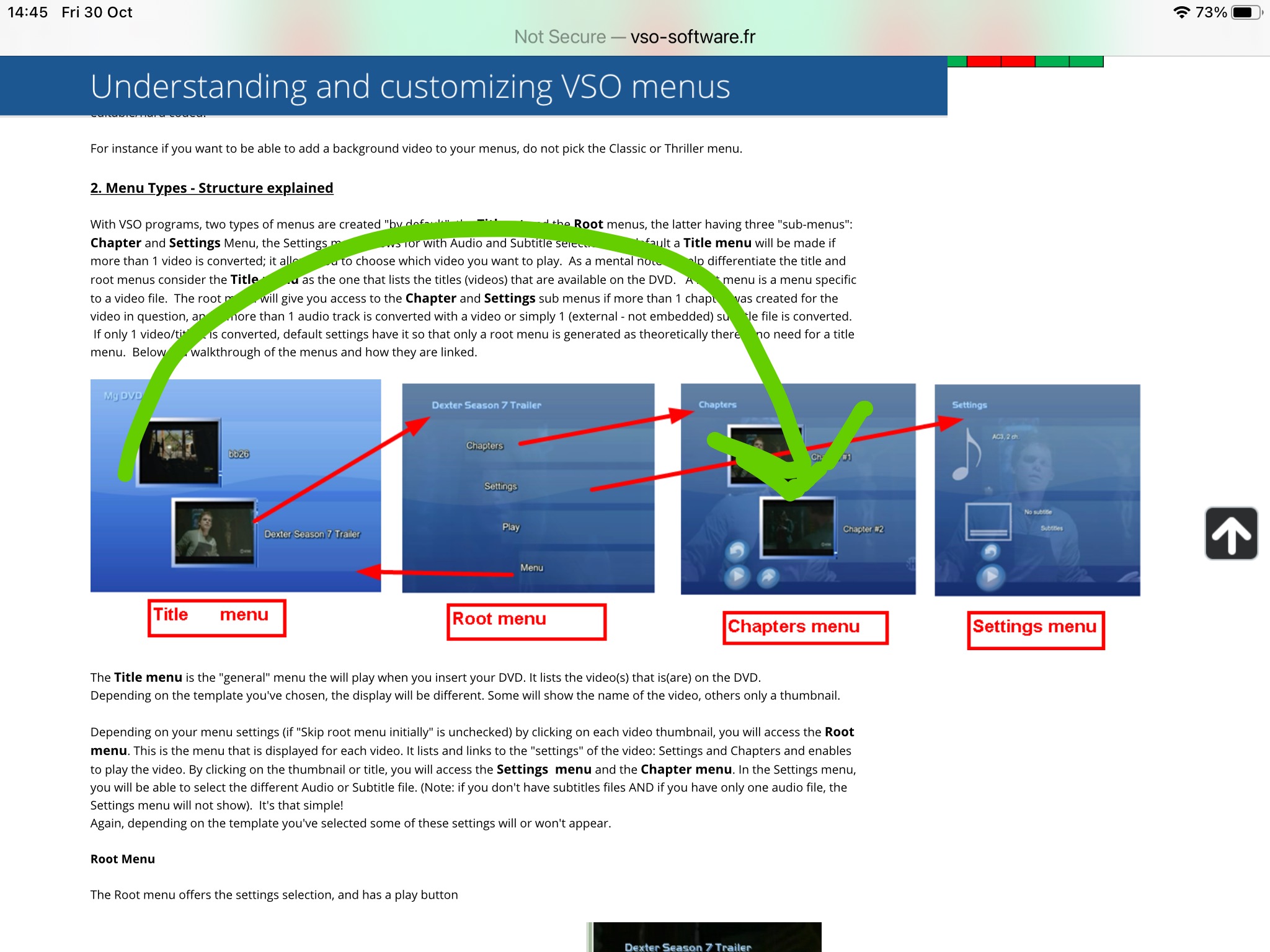

I want to go from Title page to chapter selection as per screenshot below....

From the title page ABOVE to the CHAPTER selection as below ( a lot cleaner & tidier presentation IMO )
