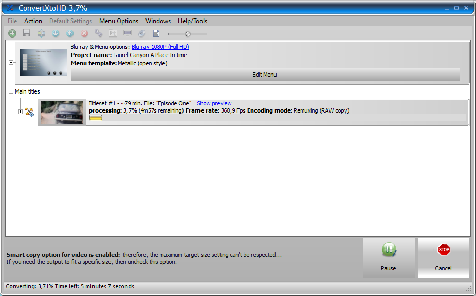

And now here are the results. I was simultaneously running Task Manager -> Performance Monitor -> Memory while the conversion runs, to see what memory ConvertXtoHD is using up while the two titles are processed. Keep you eyes on FREE, STANDBY, and IN-USE totals in the Performance Monitor window in the lower part of each screenshot. And also the specific amount of memory being used by ConvertXtoHD in the upper details part of Performance Monitor memory usage.
NOTE: screenshots (3), (4) and (5) below show Titleset2 as "paused". That's only because I pushed the PAUSE button to suspend the conversion process so that I could take my screenshots. In fact Titleset2 task is running all the way until it finally dies (along with Titleset1 which died earlier) as shown in screenshot (6).
(1) Starting, both tasks kick off.
(2) Continuing along, both tasks still running fine:
(3) Titleset1 just paused, because of insufficient available memory (according to some mysterious criteria or a program bug), Titleset2 continues to run at least for a little while:
(4) Titleset2 coming down its home stretch before it too dies, now approaching using up just about all of FREE memory (according to Performance Monitor):
(5) Titleset2 probably in its death throes, no FREE memory:
(6) Titleset2 dead now as well, along with Titleset1, and audio sings "we have a problem":

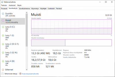

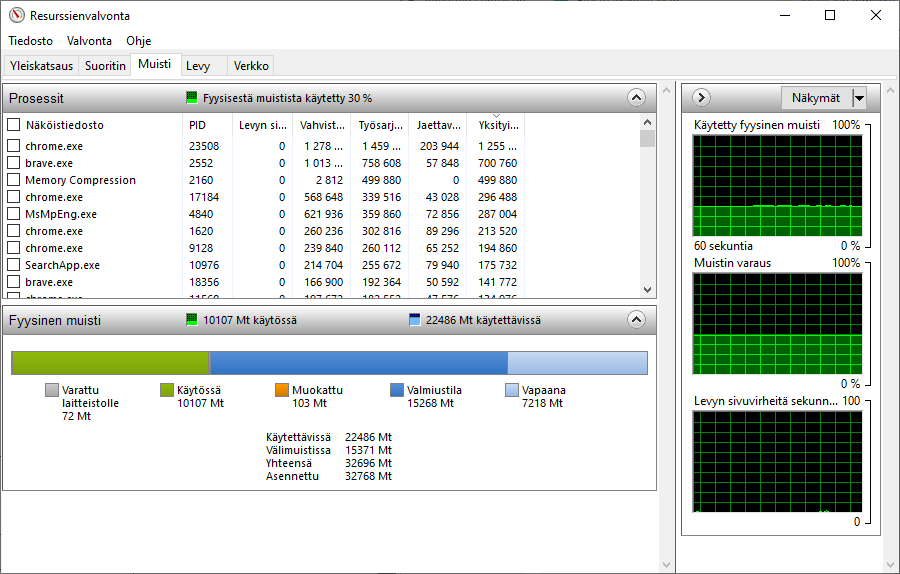

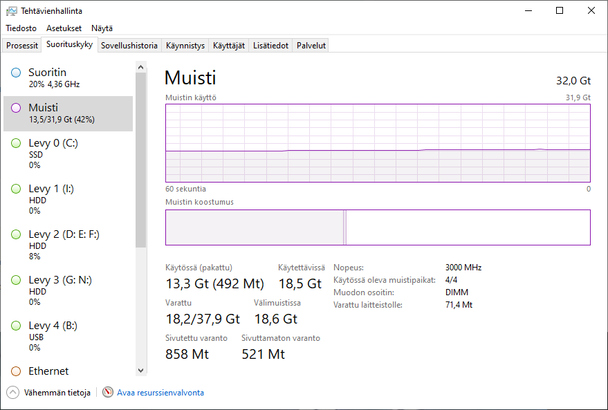

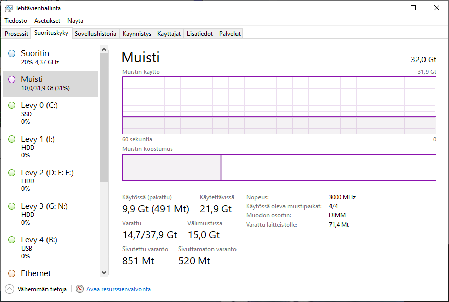

Re: Please help this newbie: fails with "running low on memory"
I'm trying to duplicate your problem, sadly I don't have files in mp4 - only in mkv format.
Same settings as yours.
No problems at all. Conversion of two movies finished in 38 minutes.

I have sent you a PM providing a download link to (a) one of my MP4 files, so that you can test with exactly the same file I am using with no success, and (b) my actual XtoHD project.
Note that my project seems different from yours, in that there are no customized chapters as your project showed, straight-through 1920x1080p to 1920x1080p rather than dealing with a non-standard input resolution file, etc. Best that you start from my project, and then you can determine if there's some particular setting I've done wrong or not done that I needed to do, in order to achieve success.
STILL FAILS, even with just one title as input. NOTE: I am using the trial version, not the fully licensed or commercial version. That may be relevant??
Bottom line: to simplify things I have now removed the second title from the project, ending up with just the one MP4 file (provided to you via PM) to produce a BluRay from. If you use my MP4 file and my project, and run with a "trial" version of the program, maybe you can reproduce my failure. If not, we need to look deeper to figure out what's different in our two environments that could explain my inability to get it to complete.
Here is the LOG from the latest one-title test.

Also, here is a series of screenshots showing memory consumption during this one-title test. The machine hasn't been re-booted since consuming all of memory in an earlier test. This new test simply is a new test, but now with just one file in the project.
(1) Initial memory state, XtoHD launched, project opened, ready to push CONVERT
(2) Memory state just after XtoHD starts, with conversion of the one file now at 5%.
(3) Memory state with XtoHD at the 30% conversion mark.
(4) Memory state with XtoHD at the 60% mark.
(5) Program continued past 60% and made it just past 70% when the program failed again, with no more available memory. Looks like "available memory" just dipped below 5GB, but I'm not sure that's the criteria for "out of memory". Anyway, this is what it looked like as quickly as I could click after the program died. The error message box just got put up on the screen, and I don't know just how much of memory as been partially released as a result of this condition.
(6) I moved the message box away, and it looks like some further release of memory has occurred.
(7) I've now clicked on OK of the message box, which seems to have resulted in a large release of memory.
(8) Closed XtoHD program, memory returned to available.

If you don't mind, I believe it would be extremely useful and helpful if you would also post your own screenshots for the one-title conversion test you run with my provided MP4 file and project definition, showing Resource Monitor output of memory utilization same as I've done.
If the test using my file works successfully for you while it fails for me, there obviously is something else in the two environments which is different and probably responsible. But unless you provide Resource Monitor screenshots while running your own test (again, at the 5%, 30%, 60%, etc.) we don't really have a clue about what is different between your setup and mine. But if looking at the comparable memory numbers something really startlingly different or revealing jumps out at us, we probably could make a big breakthrough.
A picture's worth 1000 words, so please post your own Resource Monitor screenshots during the conversion, as I've done.
I get error but in log only simple line. Need to do more test later after work.
Just had time to do one conversion. And it worked without any problems.
Only change was to disable HW conversion, all in CPU. This is a bug that has been reported before.

(1) Progress at 27%
(2) Progress at 62%
(3) State of things right after program craps out (about 69% as I recall), with message box still onscreen
(4) After pushing OK on message box, program still active
(5) After closing the program, all used memory returned to FREE/available
Ok.
Steps I took now:
Load your project, click on convert.
At start this:
Then during conversion:
And failed, stopped program and after it was closed:
