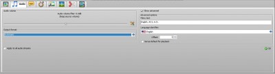

I do know about the option to check in the program that says "Convert DTS to AC-3 (better compatibility)", I do NOT put a check mark in that box. Also, above that option is another option that says "Convert Audio to format:" and I have that as AUTOMATIC. These options are in ALL ConvertXtoDVD versions from v4 and up (maybe even in earlier versions). With these 2 options set this way. DTS or ANY audio track should stay AS IS from the source. This is true with v4. This is NOT true with v6 and v7. v6 and v7 are VERY similar to each other in many ways, and not seeing a DTS audio track properly is one of the commonalities. Many, NOT all MKV movie files, in v6/v7 will see the DTS audio track as AC-3, this is BEFORE doing a conversion, this is JUST pulling it into the program! This is a very easy problem for me to reproduce and I can/will submit MKV files to admins so they can see this problem as well. For an OLDER version to see DTS properly and NEWER versions will NOT, seems to be a serious program bug or a design flaw, or both! A good analogy of this problem would be if I bought a newer car with a bigger engine, but this newer car is SLOWER than the older car with a smaller engine and I can only drive on side streets, not on the interstate roads. I also emailed tech support about this EXACT problem, below is their response, which is UN-satisfactory:

This doesn't really answer/solve the problem. So, you are REMOVING features/abilities in newer versions? Not supporting features in newer versions? WTF??? This response is really not that clear, or maybe the french to english translator jumbled it up. I am really disappointed in tech support AND the newer programs. And from the responses here, I am not the only one.

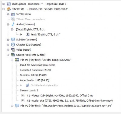

I have also attached a screen capture example of how v4 and v7 see the EXACT same movie's DTS audio track differently (called Devil's Pass - (original title was The Dyatlov Pass Incident - http://www.imdb.com/title/tt1905040/ ))
And I have a LIST of movies this happens to, not just recent movies from the 2000's. These movies are from 1990's and 1980's. So to give me an excuse on why v7 doesn't work with newer movies (but v4 does work?) just doesn't add up. Should I put my hip wader boots on for the NEXT excuse on why this is? :shock:
