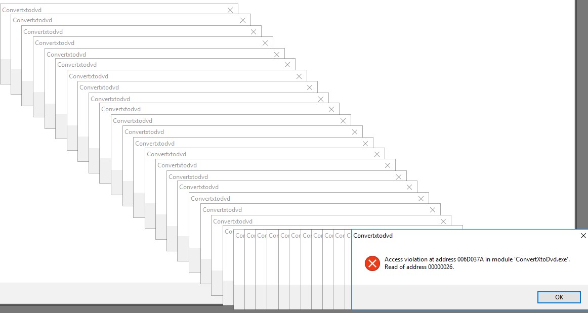

access violation
Post by mrtim »
went to use today and got this with 7.0.0.40. :shock:
installed 7.0.0.41 clean will see what happens.
Re: access violation
Have you been able to use ConvertXtoDVD since?
If not try reinstalling and
when you install please check these 3 options:
http://www.vso-software.fr/upload/Forum ... nstall.png
