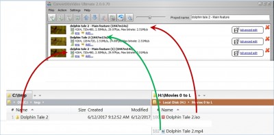

Claire,
Yes, I drag and drop media into your products.. and I did not rename it in CXTV. Before you view the attachment somethings I just discovered:
1. The "case" change does NOT occur when importing .mp4 or .mkv (and probably not with any other single file video).
2. The "case" change occurs only when importing (adding) a DVD Folder or .iso.
3. I don't care that the .iso and DVD Folder imported names include - Main Feature.
See attachment.
Imported  .iso or DVD folder name is ALWAYS lower case letters. No Problem with .mkv or .mp4.jpg
Ira
Re: Output video file name always lower case
Thanks we are going to look into it.
This will be fixed in the next build, thanks for reporting!
Should be solved now in latest beta
