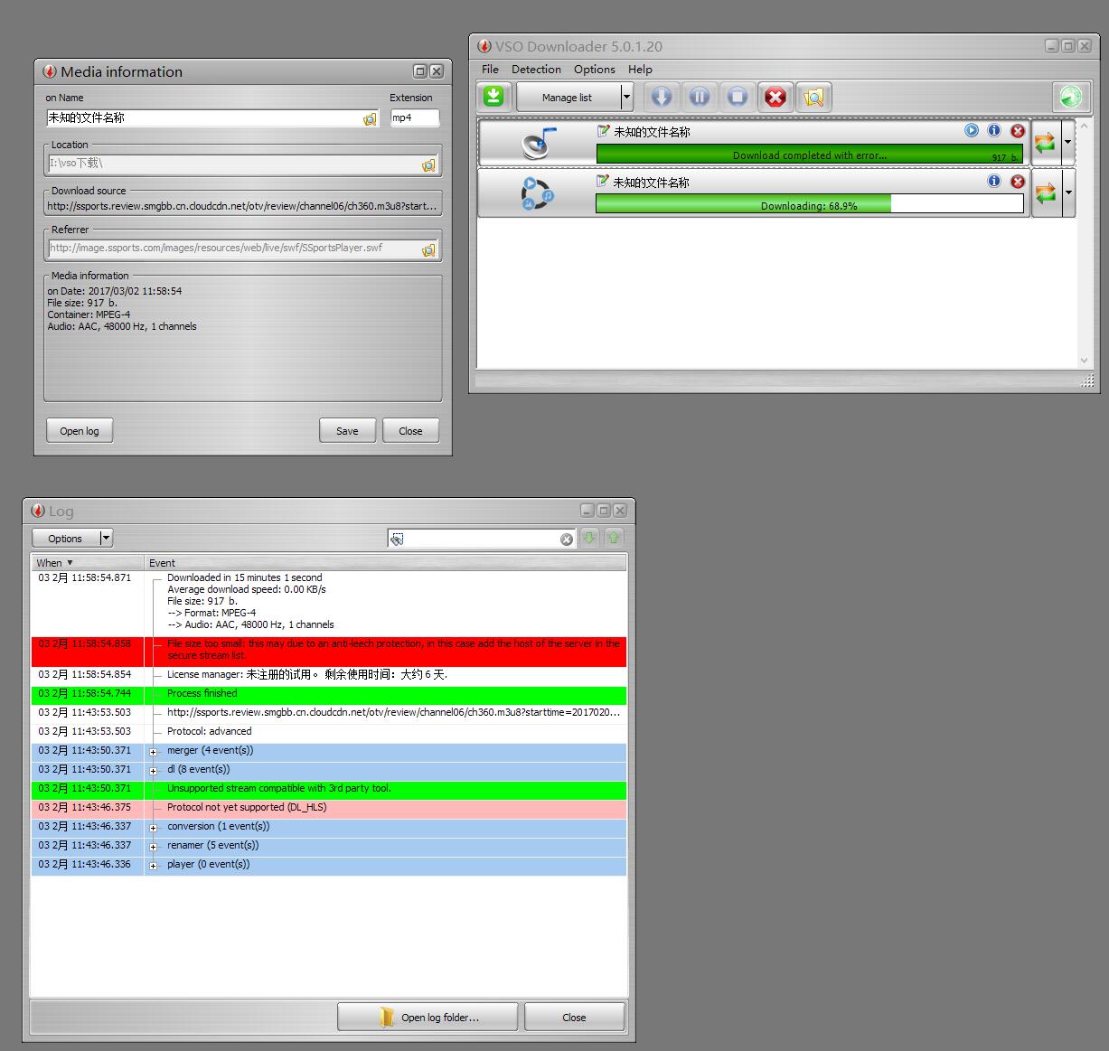

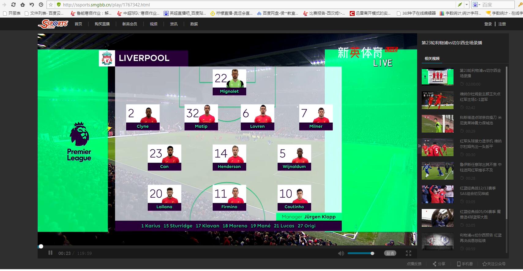

Hello,dear friends,I from china,my english is poor. so......I am sorry.
yerterday,I download vso downloader 5.0.1.20.
I want to download this video,
address: ssports.smgbb.cn/play/1767342.html
but:
File size too small: this may due to an anti-leech protection, in this case add the host of the server in the secure stream list.
you can see I upload the picture and the video,you will know what happened.
I have added the host of the server in the secure stream list.one picture show this.but it is not useful.

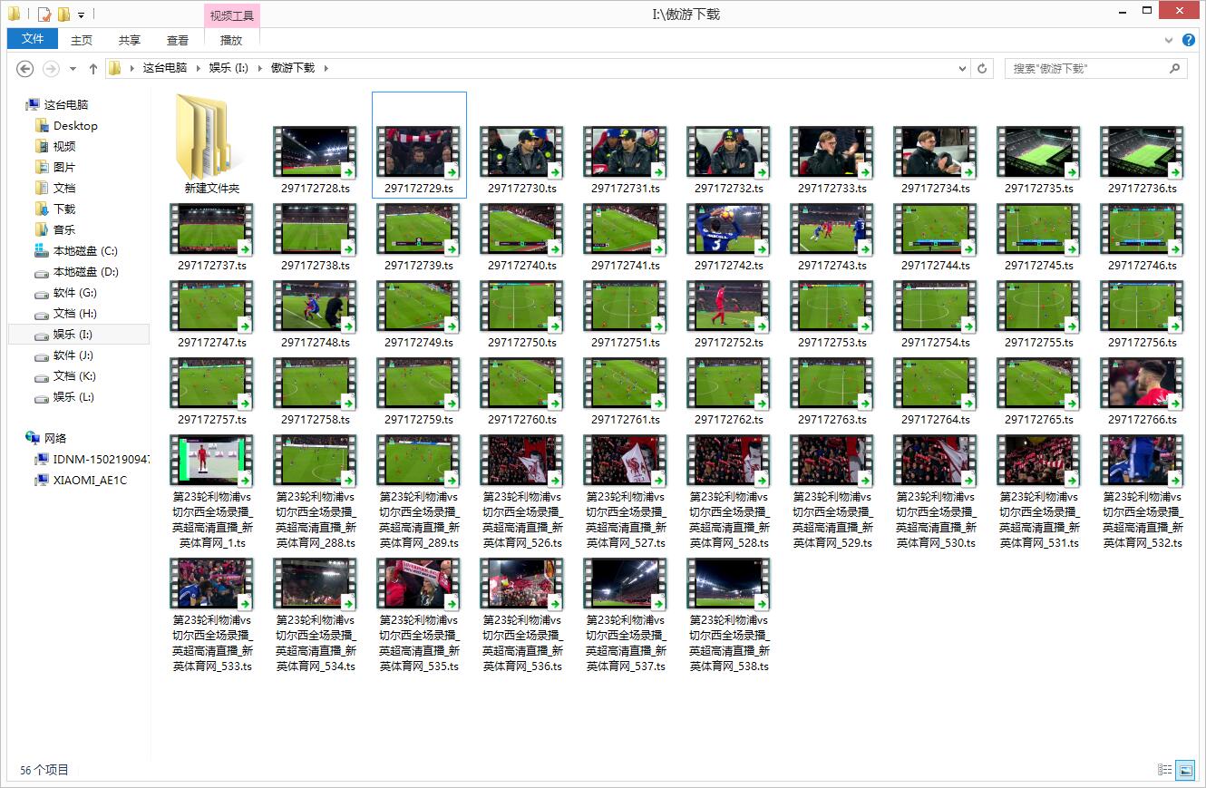

in the download folder,we can see the file is increasing,and they are easymule format,one software in China,like emule.there are about 1400 files.
every file is more than 2M byte,and if I rename it with *.mp4,I can use potplayer play this video,it is 5 second.
In maxthon,we can see,they are *.ts file,and maxthon can download someone.
now,I think it is very regretful and pity!
because vso have download the data files,and they can be played.but we can not keep them in our harddisk or get the complete video flie.When download completed.they are disappeared.
so,I come here,and I want to know,how can I get the complete video?What should I do?in vso downloader.Or is there other software or method can do it. I can read the answer with google translation.
I have try to use you-get,but you-get can not do it.
Everyone,Thank you vrey much!and forgive my poor English.Thank you!

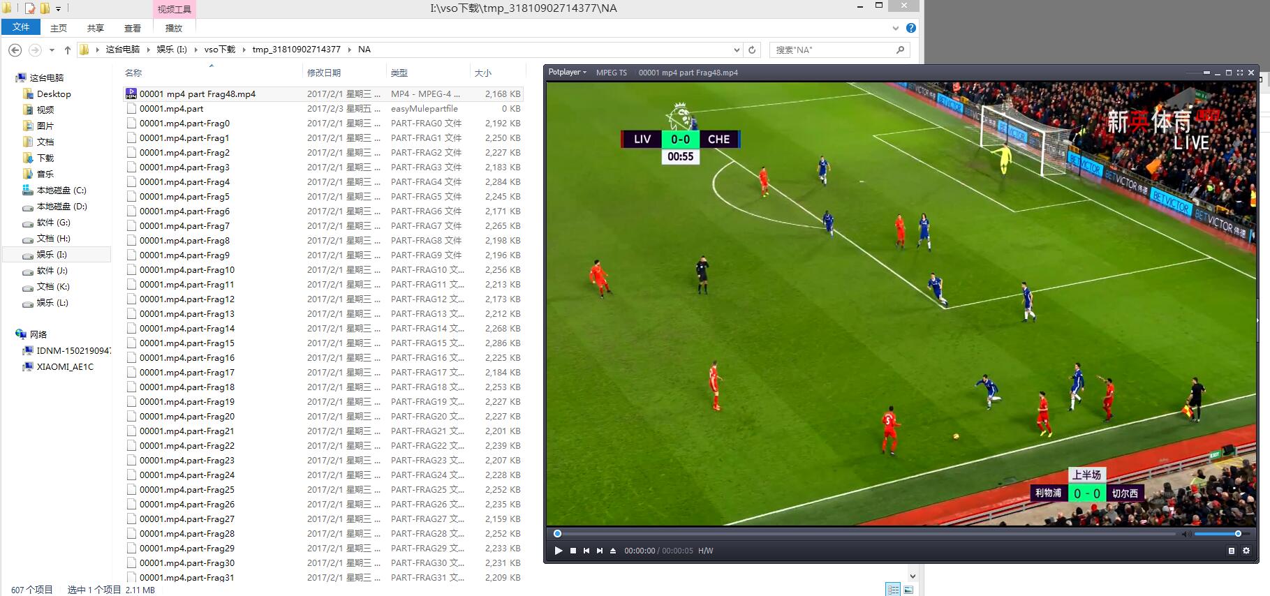

Re: From China,download completed with error file size too s
easymule partfile ,about 2MB.total more than 1400 files ,Continue increasing,until download completed,they are disappear.
but before download completed,you can copy them, if rename it, potplayer can play it.

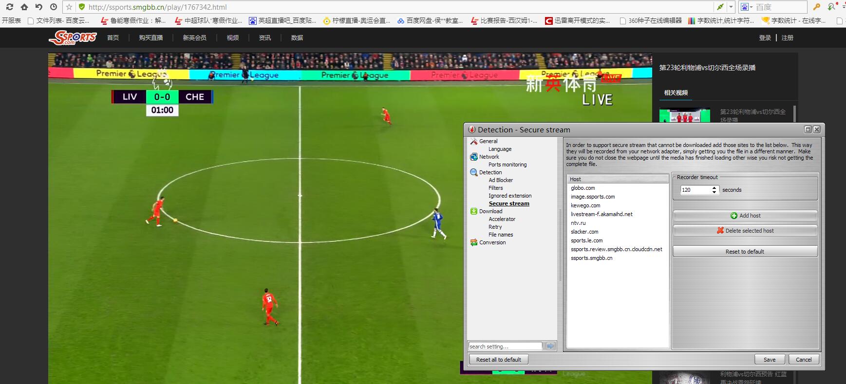

already add the host of the server in the secure stream list

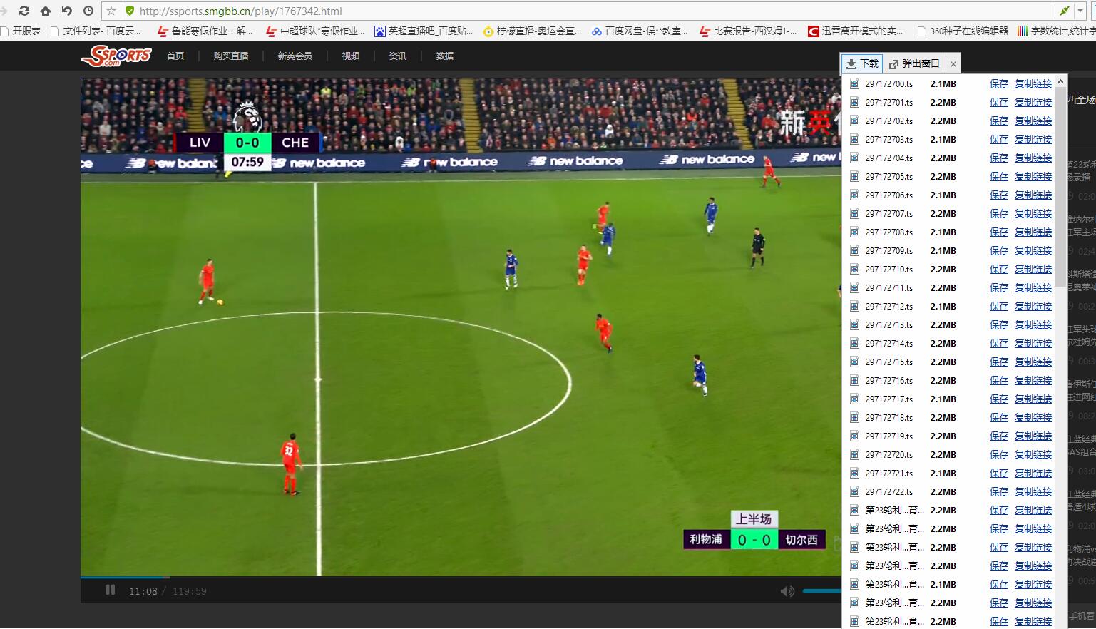

if you use maxthon,maxton can download some *.ts.potplayer can play them.

you prefectly well described the problem thanks and provided all the info to reproduce. I opened an official bug report here http://bugs.vso-software.fr/view.php?id=12577 (you can create an account if you want, I say that as not based on same account used for forum) . We will inform you if and when it is corrected.
