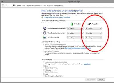

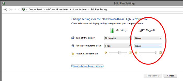

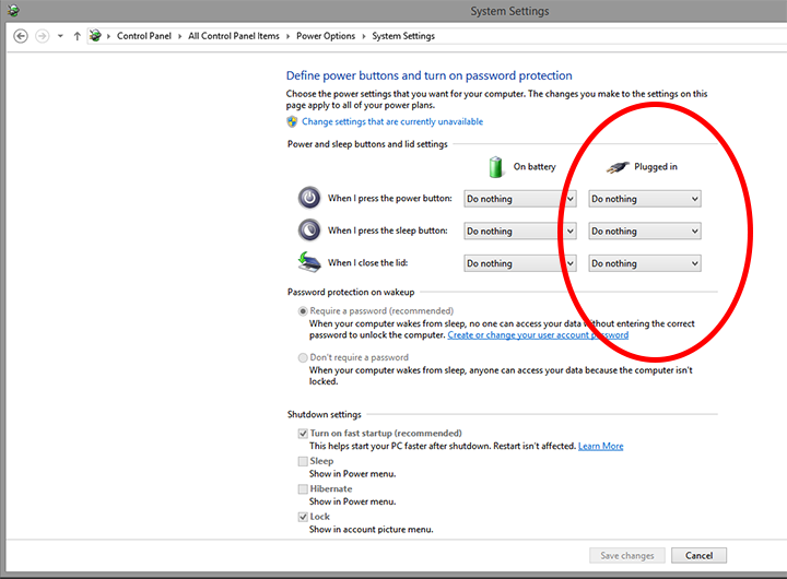

JJ wrote:I still suspect that you have in power settings "what to do when I close lid" on similar set to sleep.
I have it set up when I'm using it at home and plugged into the power that it never sleeps and the screen never blacks out, whether I close the lid or not.
