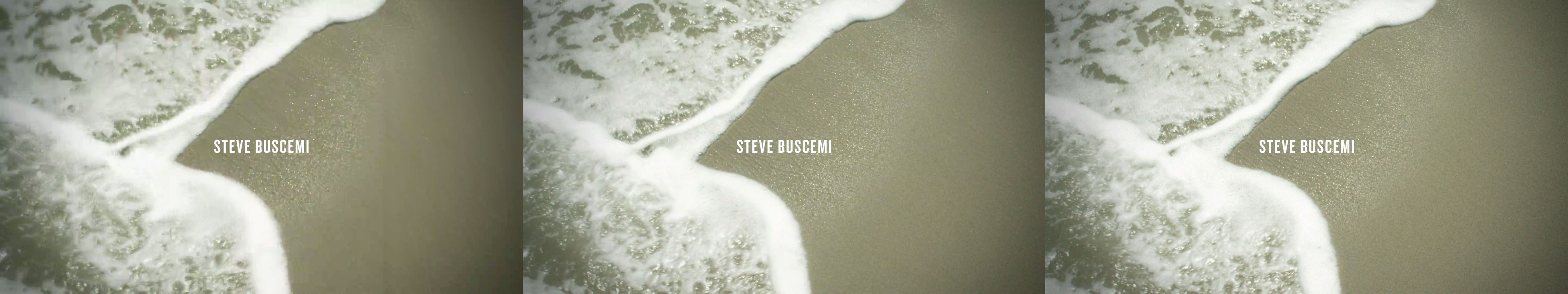

I did a couple of screen comparison shots to show the quality differences. All encodings were full 1920 x 1080 and included an AC3 5.1 audio track.
The image on the left is from VSO VC. It is using the standard H264 profile and increased the bitrate to around 6000kbps. The end file is about 3.5GB in size
The image in the middle is from Handbrake. Using the normal profile and setting the bitrate to 6000kbps. The end file is about 3.1GB in size. I got very similar results from DVDFab.
The image on the right is from Handbrake. Using the normal profile but with a Constant Quality value of 21. Looking at the file with MediaInfo the end bitrate is about 4800kbps and the file size only 2.6GB. Again very similar results from DVDFab suing a similar Constant Quality value.
As you can see from the first comparison the results are quite obvious. However, if you then look at the next couple of comparison shots, the Handbrake/DVDFab at a set bitrate and a constant quality value start to even out. The only difference is that the overall file size is smaller. I should point out that I have been getting some playback stutters from files using the constant quality settings. MediaInfo examines these files and cannot read if they are using a constant or variable bitrate where as the files that are generated using a given bitrate are read by MediaInfo as a variable bitrate.

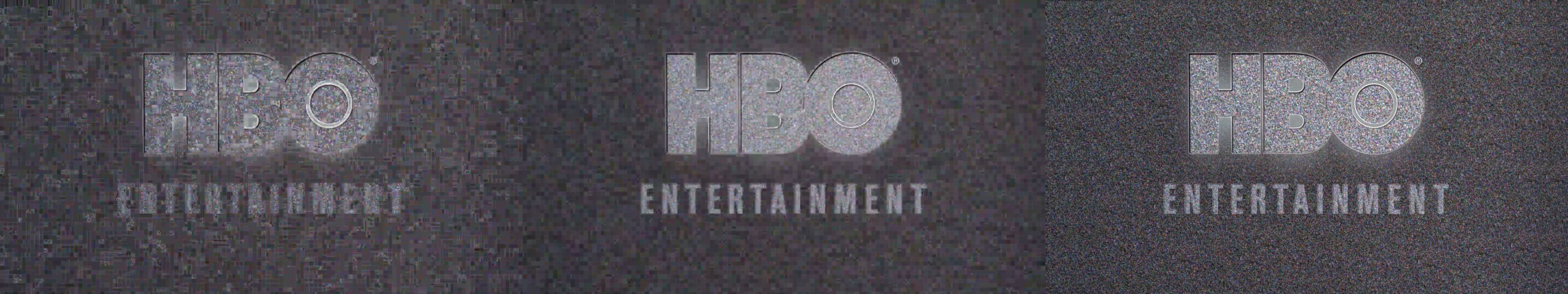

Comparison 2
Left VSO 6000kbps
Middle Handbrake/DVDFab 6000kbps
Right Handbrake/DVDFab Constant Quality Value 21

Comparison 3
Left VSO 6000kbps
