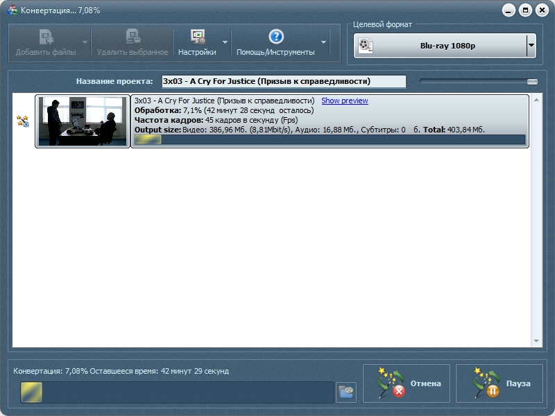

Just for testing i run a conversion of a 720x368 xvid movie to blu-ray structure of a 1080p and got only 47fps too. Using CUDA on Geforce590 and 3.3Ghz core2duo. Not using best video option.

it's not growing up to 300 as skoenig1 wrote in his message. If i convert just video to video(any to xvid) with cuda without best quality then i got 300fps.

I've got GTX 590 Asus. I know that card is working because the temperature is 74C of two processors and all time process is 45 min to convert. But maybe there's something displaying wrong. I just don't know.

cedric wrote:Maybe you enabled hardware DECODING? that's why your graphic card is working when encoding to Xvid...
Yes, it's enabled. Ok, i found that 2-pass not working. I marked that but nothing happend. Only one pass goes. And without cuda i've got only 12fps converting to 720p BD-Ray as minhcute complain. So he is kinda right. ))
