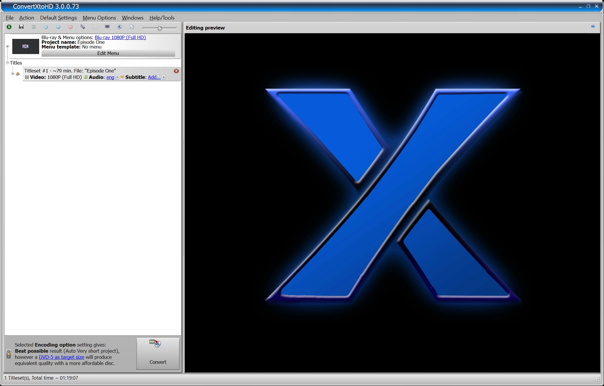

Steps I took now:
Load your project, click on convert.
At start this:

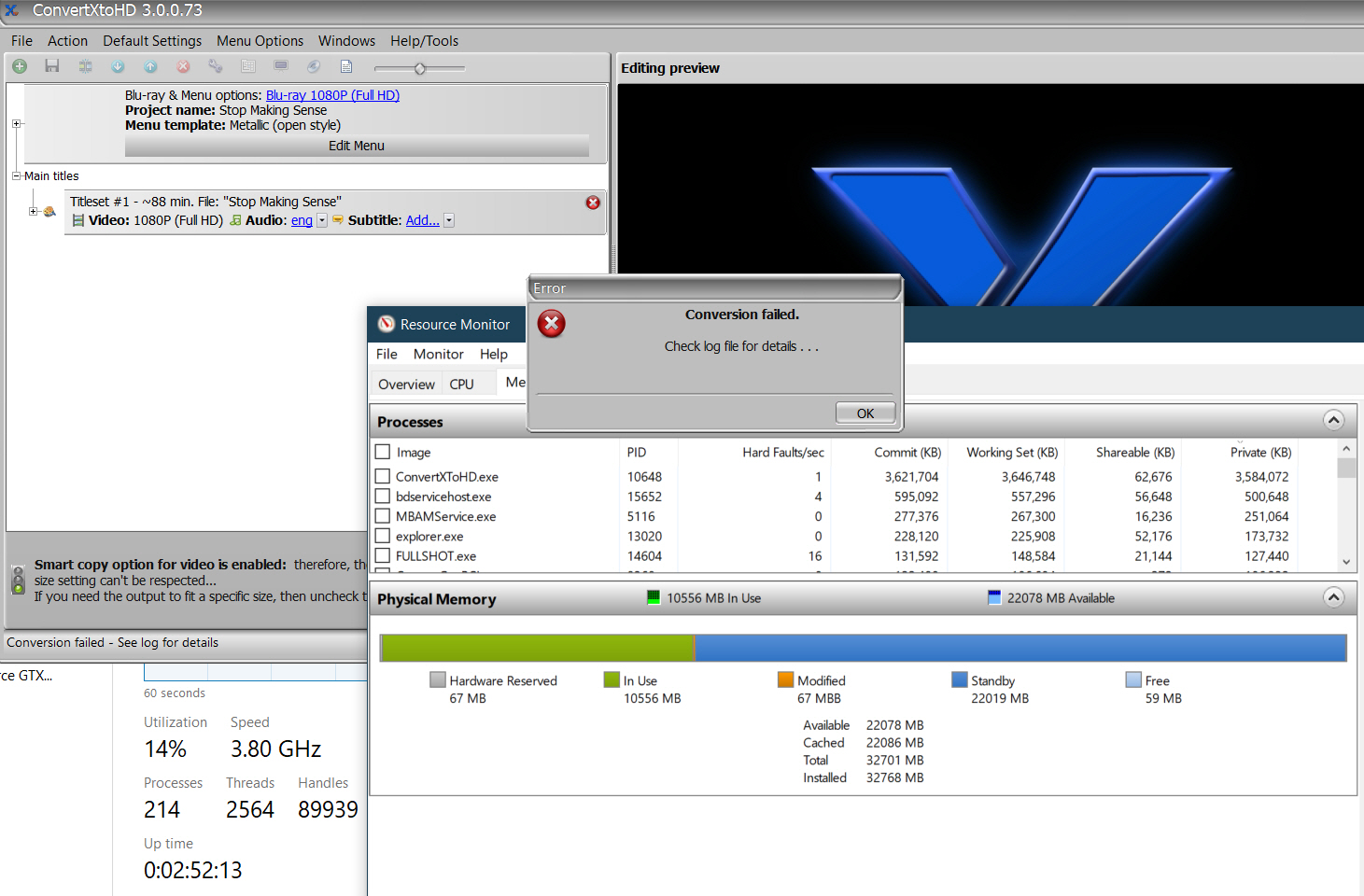

Then during conversion:
And failed, stopped program and after it was closed:
But I want to be sure I understand what you're confirming: you HAVE been able to duplicate my "storage leak" out-of-memory failure, right?
I'm not sure I follow the sequence of your screenshots, because they don't appear to reflect the correct progressive sequence of memory usage as the conversion proceeds. I would expect that early in the conversion you would have low in-use and high available. And as the conversion moves along, I would expect the in-use value to keep increasing and the available value to keep reducing, until finally some critical point is reached and the program dies with "insufficient available memory", and I don't actually see that explicitly in your screenshots.
Nevertheless, I appreciate your re-testing and posting your screenshots. Most importantly, I believe you definitely are saying that you have now been able to reproduce my failure. And that's "good news" (not really).
The VSO Tech Support people are working on this as well. They have my MP4 file (as you do), but haven't written me yet to confirm that they, too, can actually duplicate the failure. Now that you say you have duplicated my failure that would suggest VSO will also be able to duplicate the failure. And that means they should then be able to chase down what is happening.
Sure looks like they're creating the M2TS output BluRay video file in memory as one continuous ever-growing file, rather than actually writing it out to the target folder during the conversion progress.

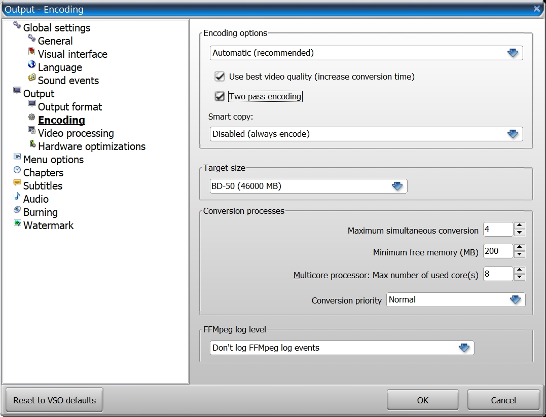

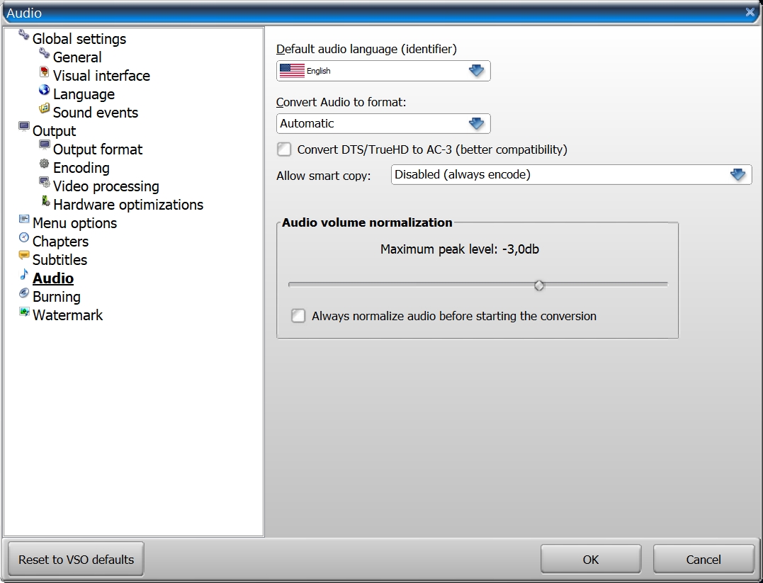

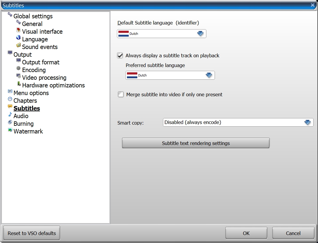

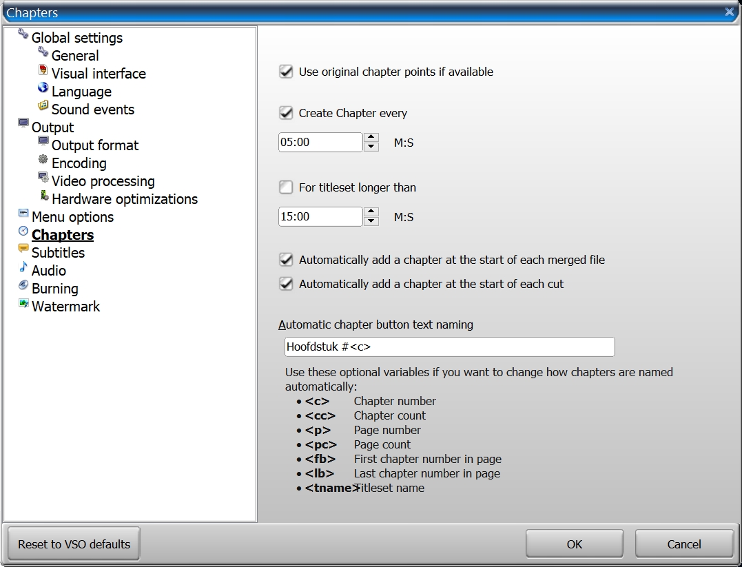

I have sucessfully converted the file without any problems.
Please check your PM.
Here are my settings:

Well, I tried using @nemesh's "automatic" setting but actually the rest of his setup involved ENCODING. When I started the test the CPU needle went up near 100% and progress was slow. I'm not interested in any transcoding or re-compression at all.I want absolutely 100% original quality on the BluRay... exactly as I get using DVDFab BluRay Creator software to accomplish the result.
I want pure input-to-output if the format is suitable. And MP4 1080p MPEG-4 input is presumably suitable for a direct-copy. I've now re-tested using my original settings, except on a 32GB Win10 machine (instead of 16GB Win10 machine) and using a different MP4 file (still MP4 1080p MPEG-4). I also changed the output from BD25 to DVD-9 (still BluRay format, so this is acutally "BD9" suitable for using a DVD-DL media to hold BDMV output).
No change. Still fails, this time at about 59%. Log still shows "raw copy" for both audio and video which is what I'm shooting for. Progress gauge moves pretty fast (fails after only 2 minutes converting) and CPU usage is only very modest, not 100% like when encoding.

NOTE: at the start of the process, log shows "memory load 27%, available memory 3564MB" on my 32GB machine.
Strangely, the log on my 16GB machine shows "memory load 46%, available memory 3528MB".
I don't know what "available memory" is intended to imply, but it's unexpected to me that it would be identical on both a 16GB machine as well as a 32GB machine.
Also, it's interesting that @nemesh's test WHICH INVOLVED ENCODING never ran out of memory, but my test which is a "raw copy" runs out of memory. Obviously there must be a different internal technique regarding memory management used by XtoHD depending on whether encoding is involved or not.
Just my observations. Still waiting for VSO engineers to provide some comment on the issue, confirming that they can or cannot duplicate my results. Maybe the fact that they haven't provided any feedback to me implies that they HAVE duplicated my results and are baffled.

Re: Please help this newbie: fails with "running low on memory"
The original purpose of this thread was to ask for help with the fact that CXtoHD 3.0.0.73 was failing to complete when running in REMUX-ONLY mode (i.e. direct copy of both audio and video from input to output, simply remuxing from MP4 input to M2TS output), producing a "running low on memory" symptom.
This "memory leak" problem was reported to VSO, and they fixed it with beta version 3.0.0.74.
Since this issue has now been addressed and resolved, I am officially closing this thread as "SOLVED".
However beta version 3.0.0.74 itself now exhibited its own problems with REMUX-ONLY mode:
(a) when two or more MP4 files are input to the conversion, the program crashes and does not complete.
(b) when one MP4 file is input the program completes normally. However the resulting output BluRay folder (or burned disc) produces NO AUDIBLE AUDIO when playing the one main title.
In order to continue new ongoing discussion of the new problems with 3.0.0.74 I have started a separate new thread in this forum. Please address your ongoing attention to problems with REMUX-ONLY mode to that other thread.
Rhis thread is now closed.
