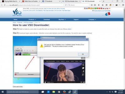

VSO Downloader with EVE driver won't install on Windows 10 Preview, continual error. Reboots or Help files give no fix. Any ideas?
EVE driver cannot detect compatible NIC.
Using Surface Pro 2
VSO/EVE install worked with the first releases of Windows 10, just not the last 2 releases.

Confirm, gives these errors:
But this is not a priority as Win 10 is far from being ready, they will most likely change code several times before it is ready for release.

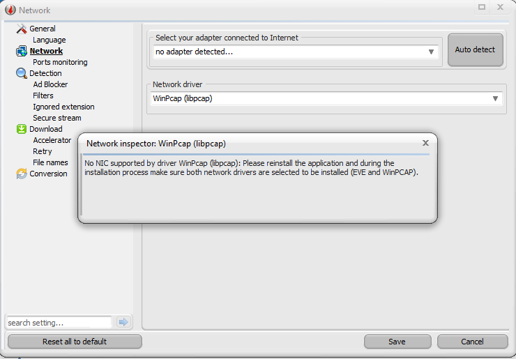

Use the WinpCap driver instead.
Re: Windows 10 Preview.
Sorry, gives same error except about WinpCap.

    2015-04-05 01:29:07.736 installation failed: Windows Error 0x800F0205 - "The device instance name is invalid.
    2015-04-05 01:29:07.736 Message box (OK):
    EVE network driver installation error: installation failed: Windows Error 0x800F0205 - "The device instance name is invalid.
    2015-04-05 01:32:20.139 User chose OK.

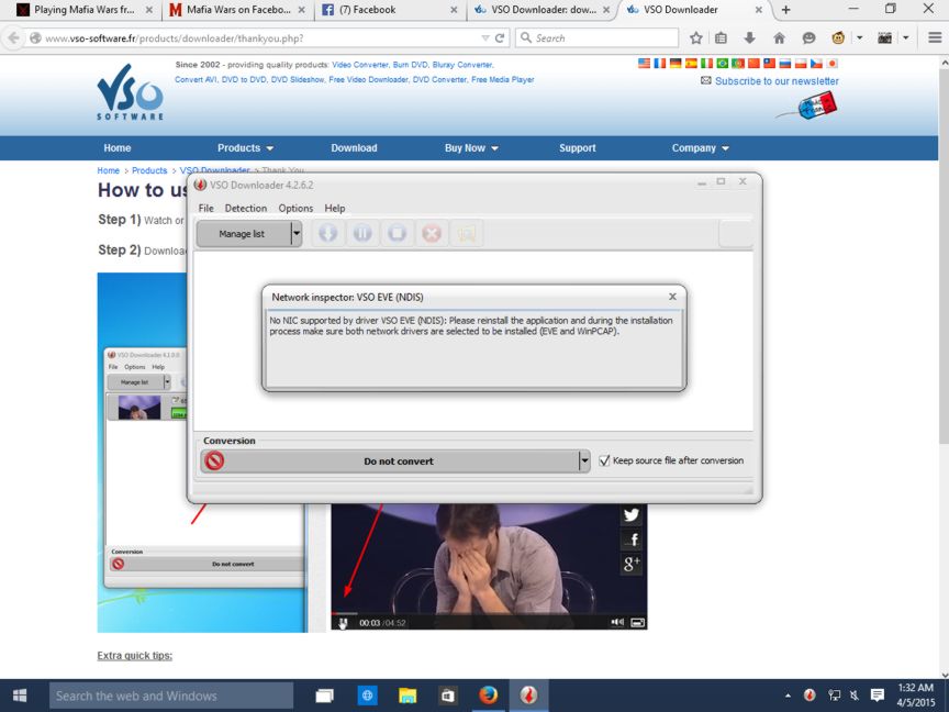

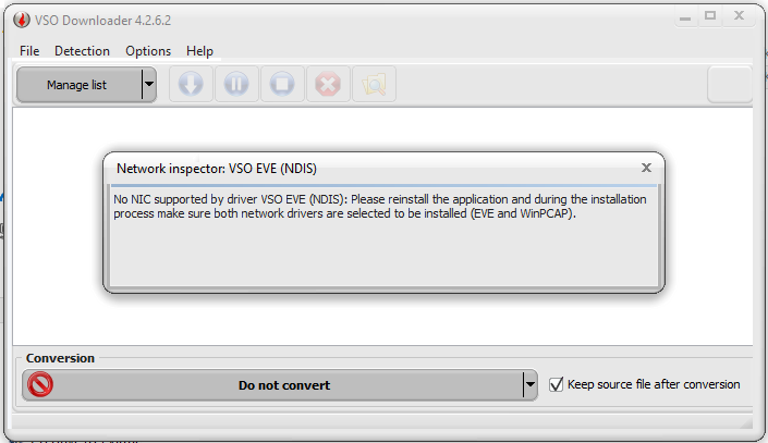

Didn't even get an error code:
"Message box (OK):
EVE network driver installation error: eve_installer"
there is an error with the device name, by now if it works with Winpcap driver you don't need to install EVE driver.
Sadly it does not.
Installing without EVE gives no errors, but starting Downloader gives this:
Then going to settings to select WinPcap:
