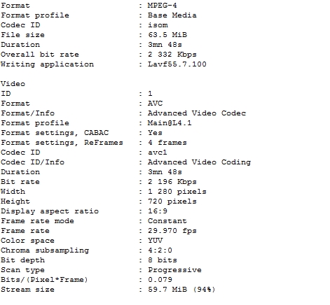

(MediaInfo reported it as 'H264 Profile - Main' instead of High which I selected.

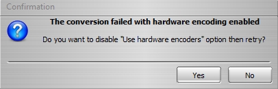

Quicksync
ConvertXtoVideo gave an error before converting and wouldn't convert.

QuickSync doesn't work when using
Custom Profile MKV H264 CRF
Custom Profile AVI H264 CRF
Custom Profile MP4 H264 CRF
etc.
If I switch the Rate Control to Constant Quantizer and then go back to CRF it works.

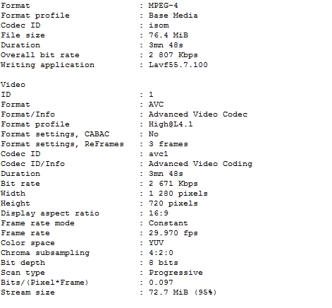

ConvertXtoVideo Software Encoding took 3m36s to convert.
ConvertXtoVideo QuickSync Encoding took 4m20s to convert. (Took longer than Software !!! lol)

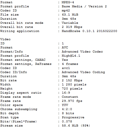

Handbrake took 1m21s to convert.

For the QuickSync not working, I will try to reproduce today, but I will need your log files and your Intel CPU specifications.

ConvertXtoVideo SOFTWARE converting (custom profile) reports the H264 profile as MAIN even though I have it set on HIGH, yet another bug.

I will check the H264 profile issue too.

I converted the same clip (3m48s) with Handbrake using the same settings as before but included 'Deblocking' set to 5.
1 minute 21 seconds (No Deblocking)
6 minutes 15 seconds (Deblocking set to 5) !!!!!
I don't know how much deblocking your program sets at but it adds a HUGE amount of extra time and to be honest I can't tell the difference in quality so can you give the option to turn OFF deblocking in the Custom Profile please ? You can see why I thought your converter is slow because you have hidden settings with no option to turn them off.

Can you fix the following :
H264 profile incorrectly set to Main when High is selected.
QuickSync not working properly.
QuickSync Crash Log.zip
Check on Format settings, CABAC and ReFrames are different. That is enough to invalidate any speed comparison.
