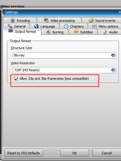

only Samsung player BD-H6500 "refuses" playing the movie. Especially when original movie has other frame rate than 23,97 (f.e. 25), there is no chance playing the movie in Samsung player.
If you are sure this is the problem have you tried unchecking this setting in the software?

Actually I'm not sure, but I WANT to allow because if original movie has a higher frame rate and converting "slows down" to 24, converted movie starts"stuttering".
But the problem sometimes happens even if original movie has a 24 framerate. Samsung player is "freezing" after about 15 sec.

If that settings is allowed then result might not be playable. All BR players have to play FullHD 23.97 and 24 FPS, any other framerate might be unplayable.
