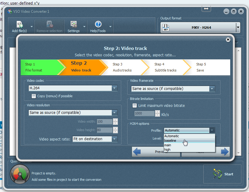

Re: Framerate change at iPod-profile
I know a lot less than what JJ is providing, but I noticed if the video codec h.264 is selected in the custom profile editor there is the option to set the profile to 'baseline', maybe a solution would be to make this setting available when mp4 video codec is selected also?
Have you tried in the custom profile editor in the 1st step, to "get profile from sample file..." and convert to a profile made from that sample? does that work?
Slevin
Posts: 8
Joined: Wed Jul 23, 2014 6:00 pm
Post by Slevin »
Hi Claire, can you tell me where to set the option "Baseline"?
When i create a new custom-profile i can select:
- profile-name: whatever
- container: MP4 Video
- video-codec: H.264
- resolution: user-defined x*y
- video aspect ratio: no access
- video framerate: 25 (or same as source)
- and bitrate: 15000
But unfortunately i can't find the menu-item where to change the format. Also i've searched at "advanced edit", without success. Many thanks in advance.
Creating a profile from sample file unfortunately doesn't regard the format, so although the sample-file has "Baseline" the new profile-from-sample-file will create "High@L4.1".
if you select mp4 container and video codec H.264 check H264 options (see screenshot)
this is in beta version 1.4.0.8
Slevin
Posts: 8
Post by Slevin »
So i'll download the beta...
Thanks Claire, that's all i've wanted^^.
