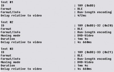

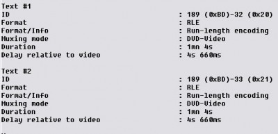

Thank you Coral fr your help,
I'm investigating, and it's seems that in fact the problem is with audio sub-stream detection...
Can you do a test?
Restart the conversion, but disable the audio track (to have only 1 video stream and 2 subtitle streams on output) then play the result in VLC
Re: Latest beta version 1.3.0.2
That's right Cedric. With no audio track the number of subtitle streams is correct in VLC player :wink:
Mediainfo result.

Re: Latest beta version 1.3.0.3
Hello Cedric. I'm sorry but the problem is still there. The only way to get the correct number is to remove the audio stream.
Can you do a clean install (by removing installation files and registry entries) ?
I can't reproduce on my xp pc here where the bug was reproduced...
I did a clean install and removed the registery entries I could find. I still get an extra subtitle stream.
This is what I have tried before I did a clean install:
(1) I have converted the (Original) mkv file. This converted with an extra stream.
(2) Converted the file produced by the converter.
Result: In this file (2) the number of subtitle streams are correct.
Does this make sense to you ?
Note:
The extra stream is produced when there is more than one stream.

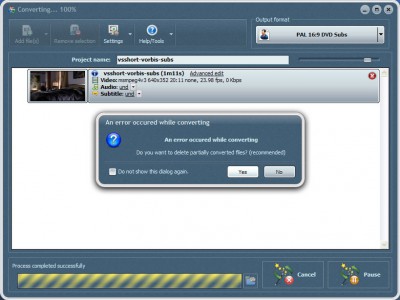

Re: Latest beta version 1.4.0.0
Hello Cedric,
Files with subtitles are not being converted when set for DVD subtitles output, MPEG2-PS (WinXP)
I still get an extra empty subtitle stream, on both my machines. However I just have to accept it since nothing can be done about it. (http://bugs.vso-software.fr/view.php?id=8035)
I have uploaded a MKV file for your attention. Please test for DVD subtitles.
Coral wrote:Hello Cedric,
Files with subtitles are now being converted :D I still get an extra empty subtitle stream :( Just to let you know.
