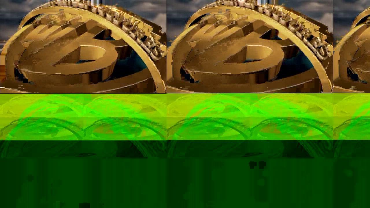

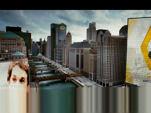

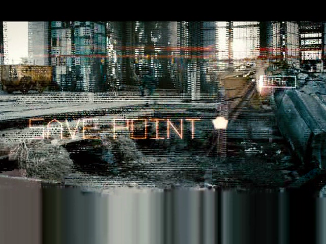

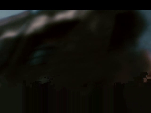

i have listed it though...............and EVERY DVD no matter what it is or region comes out corrupt.........as I have described...........
Still no fix.........getting on for two weeks.......I would of expected even more than one update in this time never mind none.........
If you use your own built in low profile xvid profile EVERY DVD comes out corrupt as like in the two enclosed screenshots.....(region 2 Gamer .....but every dvd anyway)..........check bottom of screen

Here is my custom profile........same settings etc work fine in 1.4.0.8
enclosed......profile and 4 screenshots
straight from disk and from rip on hard drive

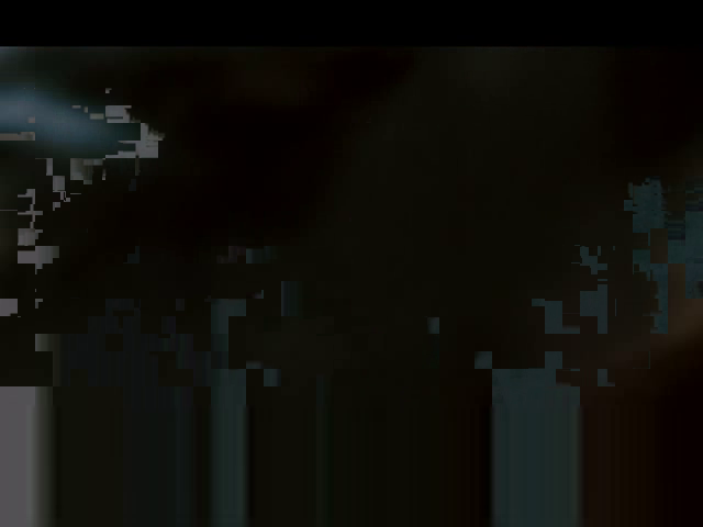

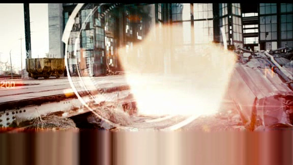

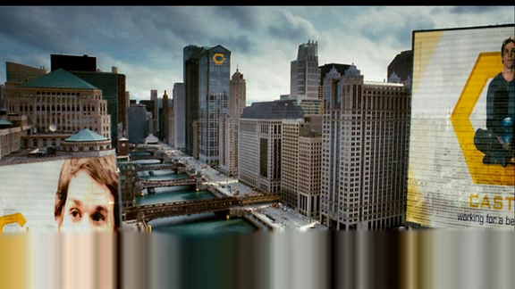

and to show im not lying about nothing working Ive just tried contagion with another one of Y O U R profiles...............720p hd xvid
heres a snap of how that comes out...................Im not blind
