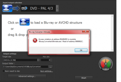

But it absolutley does not work on Windows 7 x64. There I get an "access violation" error when I try to open the advanced settings. And first of all on Windows 7 x64 when I try to open the exe I get the error " list index out of bounds (2).
Unfortunatley the list index out of bounds error also occurs with the version 1.3.0.2
As I said, all works on x86 systems correctly but not on x64 systems.

The same error occurs. As I said before. It only occurs on x64 systems.
I have the latest nVidia drivers installed, Service 1 and all patches and hotfixes for Windows 7 x64.
Maybe there are different dependencies on x64 systems?
And one more item on the x64 system when I try to open the Advanced sttings tab:
As attachment of this post
Picture of access violation when opening Advanced settings tab
Re: New VSO Blu-ray Converter Ultimate BETA version (1.4.0.5
I don't think the problem is related to x64 OS because I tried to reproduce on 3 Win7 x64 computers without "success".
The problem can be with NVidia card, will try to reproduce by considering this point.

There must be something wrong with the programmed code, I don't think it's the driver, because I found a solution maybe it is useful for your development. And I love this app that's why I post here.
As I said before the list index out of bounds still occur.
Now to the advanced settings tab. It now works but it was a hard work to find the solution by trying this and that...
OK, If anybody has the same problems with it, just: Click to load a Bluray or AVCHD structure
Then load from folder and select your movie. When the folder structure has loaded successfully
after all the Advanced setting tabs work.
Maybe this is useful for the developers.

Are you saying that if you click on the "Advanced Settings" button before loading a video, you get the error?
Is this still happening?
The only way for you not to get the error is to load a video first then click on "Advanced Settings"?
Thanks for your help.

I am saying this before loading a movie, this error occurs.
And this error sill occurs.
Clicking the advanced settings tab first does not work at all.
I noticed something else. The list out of bounds error message pops up when 1 or 2 registry entries are missing. Does not matter which one. Your installer creates those entries in HKCU...
Can't you make it happen that the intalled exe creates those entries? Because the installer missed installing the proper entries. Just a suggestion. Just like, for example img burn. IMGBurn creates those entries when the application starts the very first time.
You must know I create installers by myself with Windows Installer Technology and I know what I am talking about.
Re: New VSO Blu-ray Converter Ultimate BETA version (1.4.0.6
A new version has just been posted, can you tell me if you still get the error with it:

Re: New VSO Blu-ray Converter Ultimate BETA version (1.4.0.8
Post by KaiK »
Sorry for my late reply. Was pretty busy.
Well, everthing seems to be working now. Will check out some more items.
Good work.
Cheers
