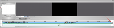

Merging multiple files can be done by first loading one clip, then adding to that file.
Posts: 436
Re: Merge Files With VSO ConvertXtoVideo
Just adding a small screenshot to JJ's post:

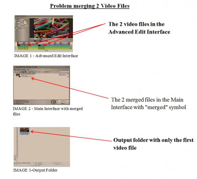

Hi everyone
I am trying to merge two video files with ConvertXtoVideo 2 (Latest version), but only the first file comes out in the output folder. I've tried several times but same result. Apparently 2nd file does not seem to be merging with the first although it appears in the main interface as having merged. I attach a file with all three 3 images to see if someone can help.
Image 1 is an image of in the "Advanced Edit " interface showing the 2 files on the Video structure timeline; Image 2 is an image in the main interface after Advanced editing ; Image 3 in an image showing only one of the comes out in the output folder.

Thanks Thomas 54.
The problem is not that I have not followed the user guide. In fact what you said is exactly as it is in the user manual. The problem is that the conversion process goes through to the end without a hitch. But at the end of the conversion, only the 1st file is shown as in the output folder as I have indicated in the image attached to my previous posting.
If the 2 files are converted, the output is a 2-hour movie file. On this occasion, only the 1st file (44 minutes long) appears in the output folder! I repeated the process about 4 times and got the same result.
To find out whether something was wrong with the recording of the 2nd file, I used on old software, Windows Movie Maker, and it converted both files into one perfectly! Microsoft no longer supports the Windows Movie Maker on its OS beyond Window 7, which is why I made the switch to ConvertXtoVideo. Does anyone in VSO Support department have an explanation regarding my current experience? Thanks
