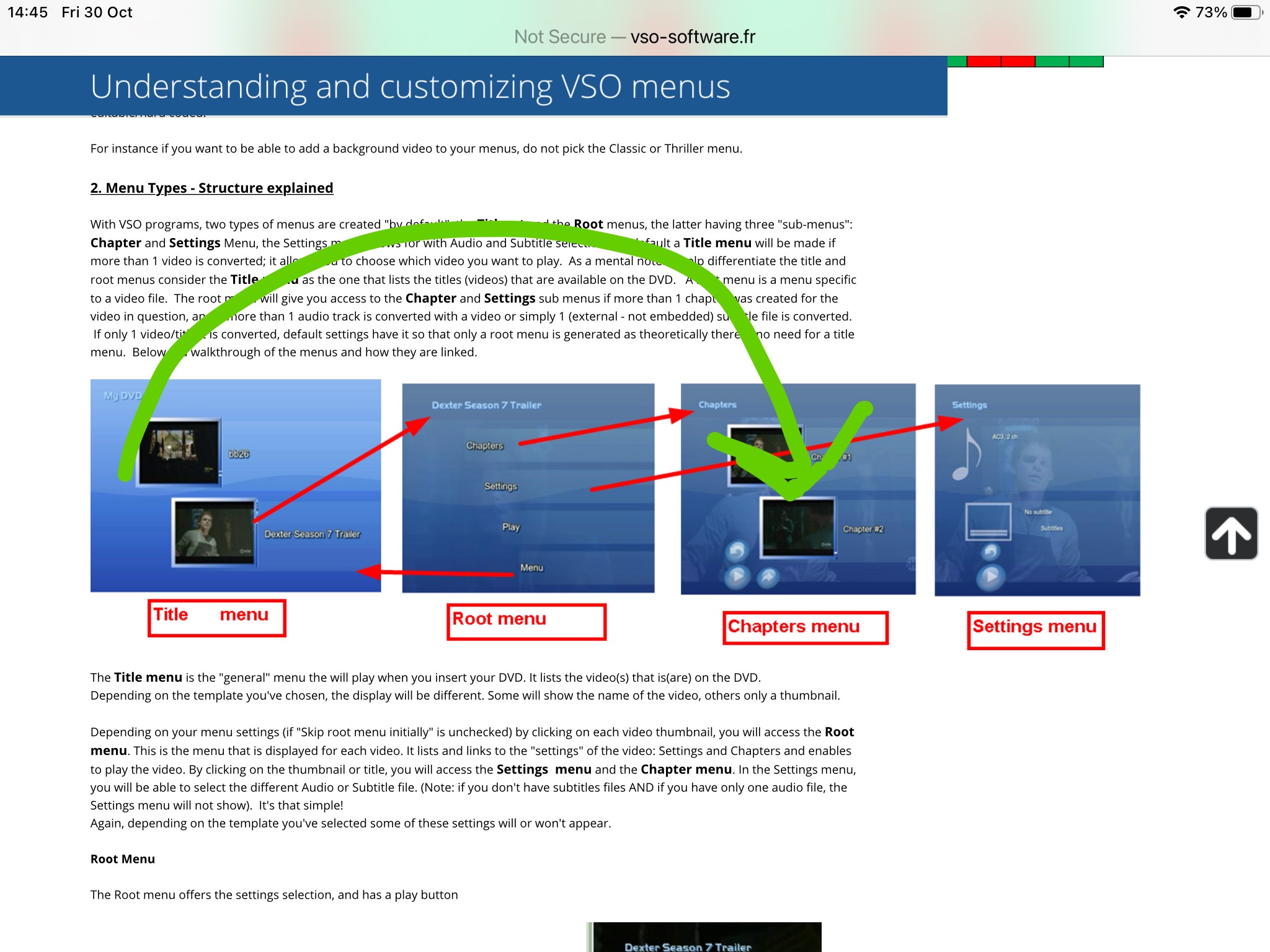

Hello
Will fire up ConvertXtoDVD and have a play, but with Tmpgenc authoring works 6, it’s so much more straightforward.....add all video files , which are in Title 1, then click Title 2 and add the next lot of video files....first page then has Title 1 & Tile 2 which point to the Representative chapter Pages....or can add chapter points in the timeline and they appear exactly the same as added video files.....
So at the moment I can’t see how to do the same in CXtoDVD, how to add video files to different Titles....oh well maybe it will become clear when I try later.....CxtoDVD is a very well presented program, but maybe this part of it could be made easier as with Authoring works 6 🤞
UPDATE just reading through the manual, it says as each new video is entered it connects to the next Titleset so assume I would have to merge the individual files to create chapter points, whereas in Authoring works 6 they remain as individual files but still show as chapters......curious

Found how to `MERGE` video titles into Track 1,
I thought the `MERGE` referred to was on the video timeline
However, the `Chapters` created are named Chapter 1 Chapter 2 Etc. is there a way to retain the original file names when they are merged into Track 1 ?
Also having problems with Titleset 1 & 2, they display ok, but when clicked on they play the entire chapter set, want to display a page with the chapters so can be chosen individually.
thanks

Not getting very far with a solution to my problem.
I add 4 video files And they all are created with title sets 1-4....so I merge them to Titleset 1
Then add 4 more video files which create as title set 2-5....I then merge these as title set 2
I now have Titleset 1 with 4 files ( chapters 🤨) and Titleset 2 with 4 files ( chapters 🤨 )
Now when I click on tile 1 or 2 in the Title page, I want to go to the chapter menu page(s)
So title 1 goes to the chapter menu for tile 1 etc.
BUT clicking on Title 1 or 2 takes me to the root menu....
Can this ( I hope 🤞🤞🤞 ) be configured this way ? Thanks

Hello
Still looking for a solution....
I have added several video tracks and merged them as Title 1
Then I added some more tracks and merged them as Title 2
I renamed Titles 1 & 2
I choose VSO glossy with 10 items per page, but when I select Simulation and click on one of the Titles it goes straight to the first Chapter ( Video track ) I want it to go the the Chapter pages.....so how do I achieve this please ?
