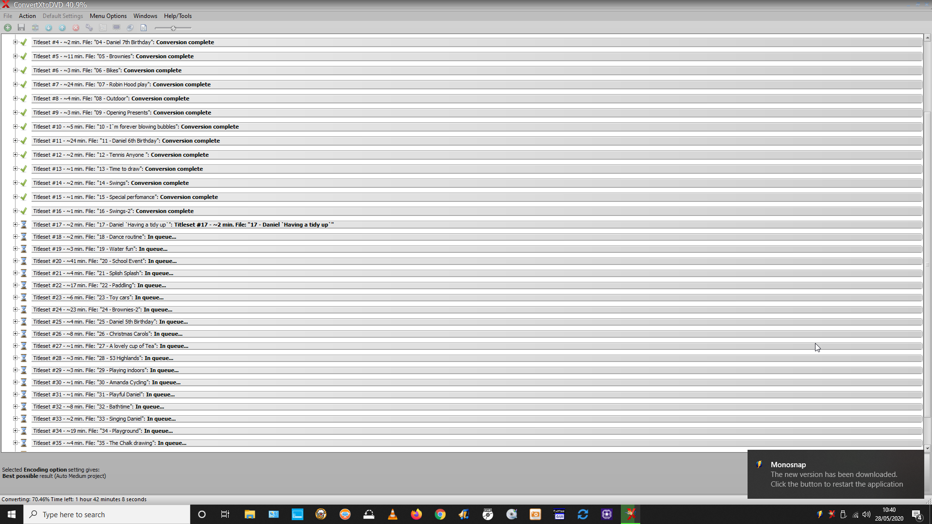

Conversion gets stuck
ArthurDent2020
Posts: 60
Joined: Wed May 27, 2020 12:13 pm
Post by ArthurDent2020 »
Convertxtodvdlog.txt
(72.33 KiB) Downloaded 775 times

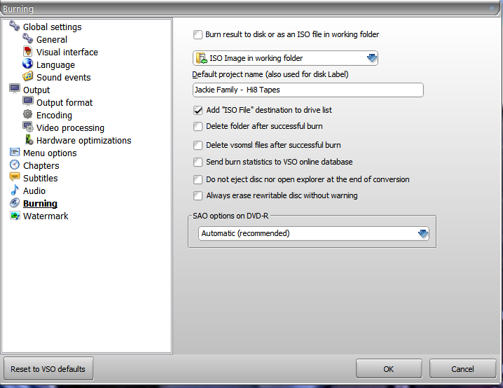

used these settings, but although the conversion completed and the PC shutdown, the Video TS folder was EMPTY....
any thoughts ?
error.txt
(6.95 KiB) Downloaded 687 times
strange thing is, with the selections made in the BURN window, would have thought an ISO file would have been created burn it wasnt ??? which is again why I think the options in the BURN screen are ambiguous
