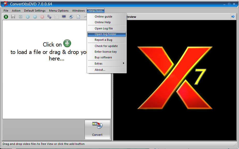

Re: "Working folder not accessible"
Here you can open folder where logs are.
