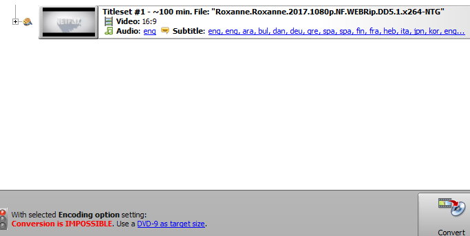

Saw this for the second time. Easy solution was to get rid of some of the subtitles, and then the program worked just fine. latest version 57.
this is just an fyi,
hope this helps.

Your movie file has subtitles alredy contained inside the file. And you are probably adding more of the same language.

Obviously my "Subject" line was incorrect. The 'creator' of the file was trying to ensure that there were subtitles for as many people as possible. Good for him or her. I was simple trying to show that if you tried to convert with "all" of these subtitles included that ConvertX would not allow you to do so. Again, the simple solution would be to delete the ones you don't need and then the process could go forward.
And "NO" I did not add any additional subtitles. And while there seems to be some duplicates, I did not "add" them. There was "NOT" an additional subtitle folder.

Your report has been noted. Bug ID. 13482 "Embedded Subtitles in MKV are not all converted to DVD"
It should be fixed in a future version.

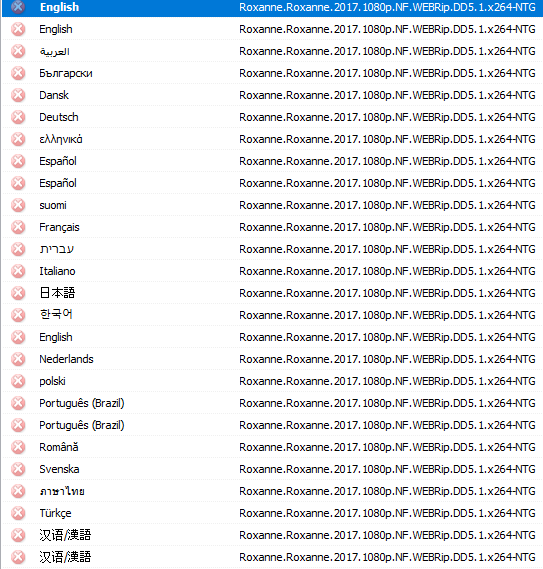

Understood, I downloaded the following file: Sun.Dogs.2017.1080p.NF.Webrip.DD5.1x264-NTg. It did "not" contain an 'external' subs folder. When file is loaded into convertxtodvd with latest version "59", it showed "25" subtitles, and it stated it could not be processed. As previously stated, upon removing some, and in my case, most, of the subtitles, I was able to proceed with the conversion.

Just a little followup. As previously stated the above file with 25 subtitles would not process, upon removal of '2' subs, bringing the total down to "23" the process could continue. Again, I only really wanted only "one", in my case, English, but the fact the file contained 25 or maybe more was good so that people could get the "one" they needed. Just to add to the comment by CLHatch, I was only making a DVD with this "one" file. Not several movies on this one DVD.
