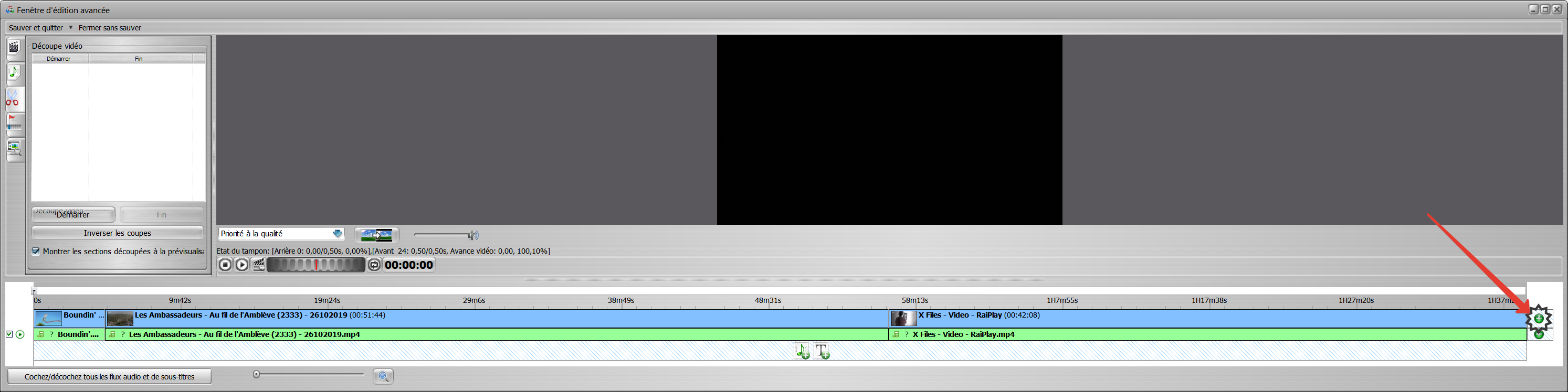

Posts: 379
Re: Merge Files With VSO ConvertXtoVideo
Just adding a small screenshot to JJ's post:
