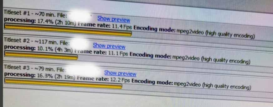

A saved project, on my old PC the speed results follow, is W10 64 i5 3.4gh 16GB DDR4 Ram and very old Video Radeon HD7750 2gb.

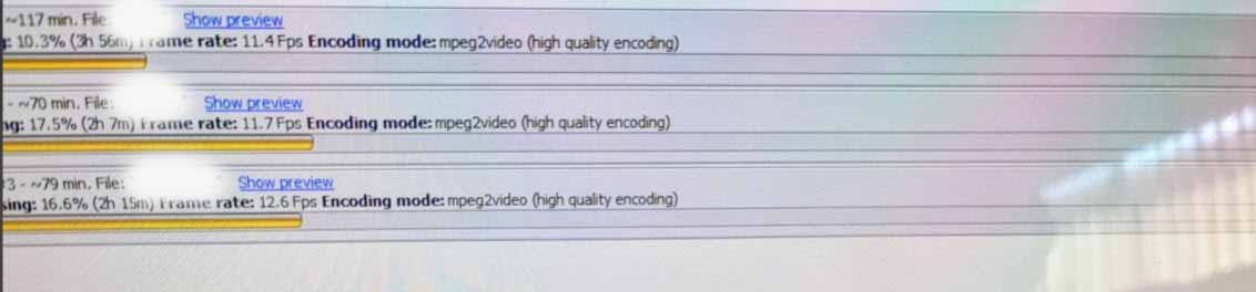

Same files added individually, I do not see any change in speed of conversion

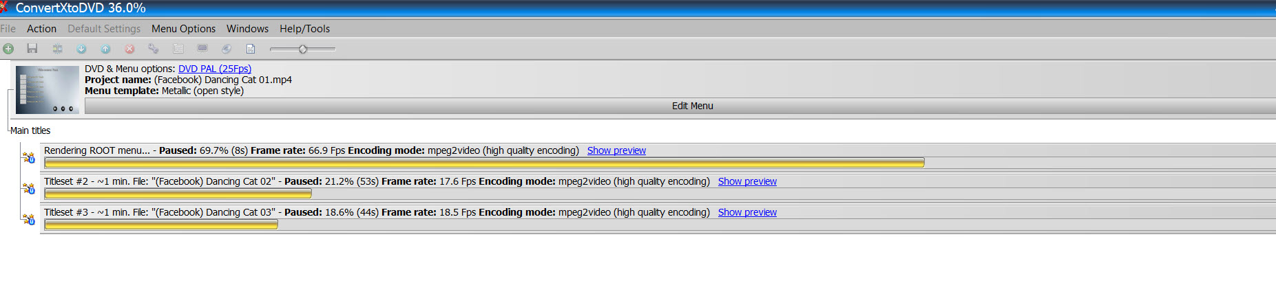

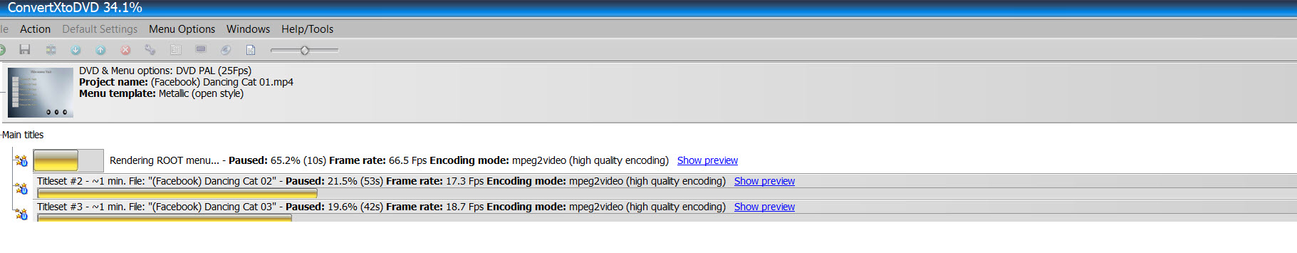

Results below comparing:
first - loading of 3 files individually
second - project of the 3 files
To me the results are the same, makes no difference
