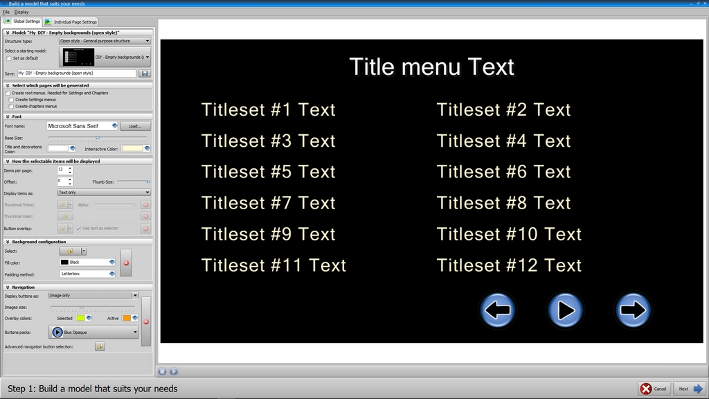

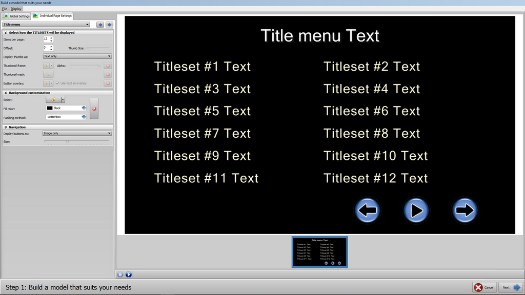

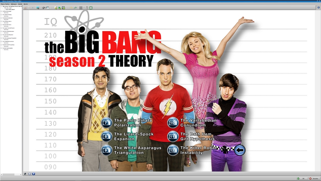

Menu is created with the 'General Purpose Open Style, see Screenshots 1/2 & 3
The menu has 2 pages because each disc has 12 episodes.
Did it like this:
Season 2 Disc 1 - Page One Episodes 1-6
Season 2 Disc 1 - Page Two Episodes 7-12

Removed from the menu the 'play' button and only have the the two arrows 'to go to
the next page' and the 'go back to previous page' arrow.
The menu-navigation works fine.
Going to page two and back to page one works well.

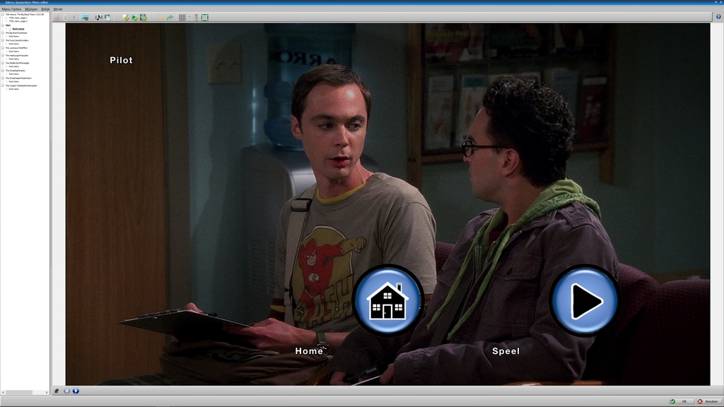

It jumped to a 'sub-menu 'were I see the following (see screenshot 9).
The I have to use the 'play' button to start the episode.

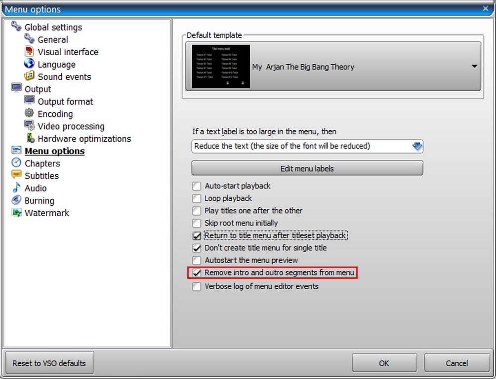

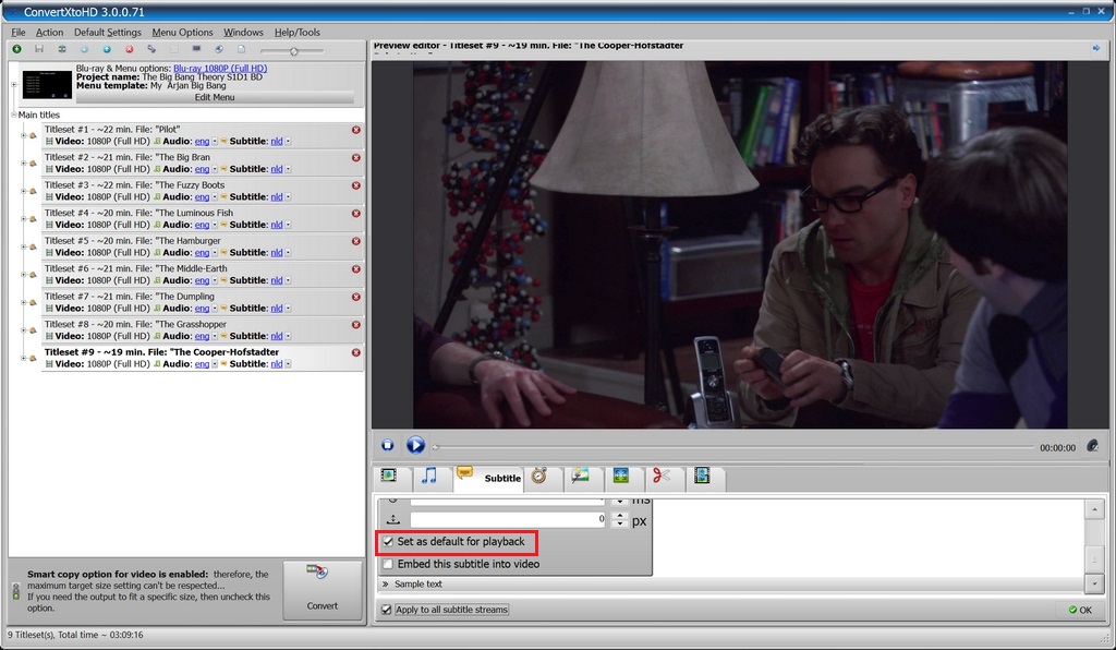

Disabled this by selecting in the menu 'Remove intro and outro segments from menu (see Screenshot 4).
This did 'the trick' when I selected a episode the player started to play the episode right away.

Have only the English audio and 1 subtitle (in my case Dutch)

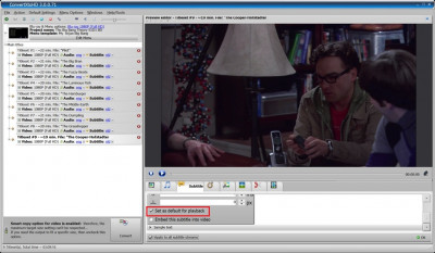

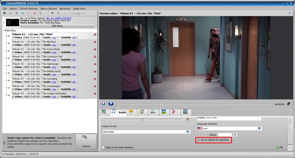

Both are set 'On' after I have added them in ConvertXtoHD:
English Audio,see Screenshot 5
Dutch Subtitle see Screenshot 6

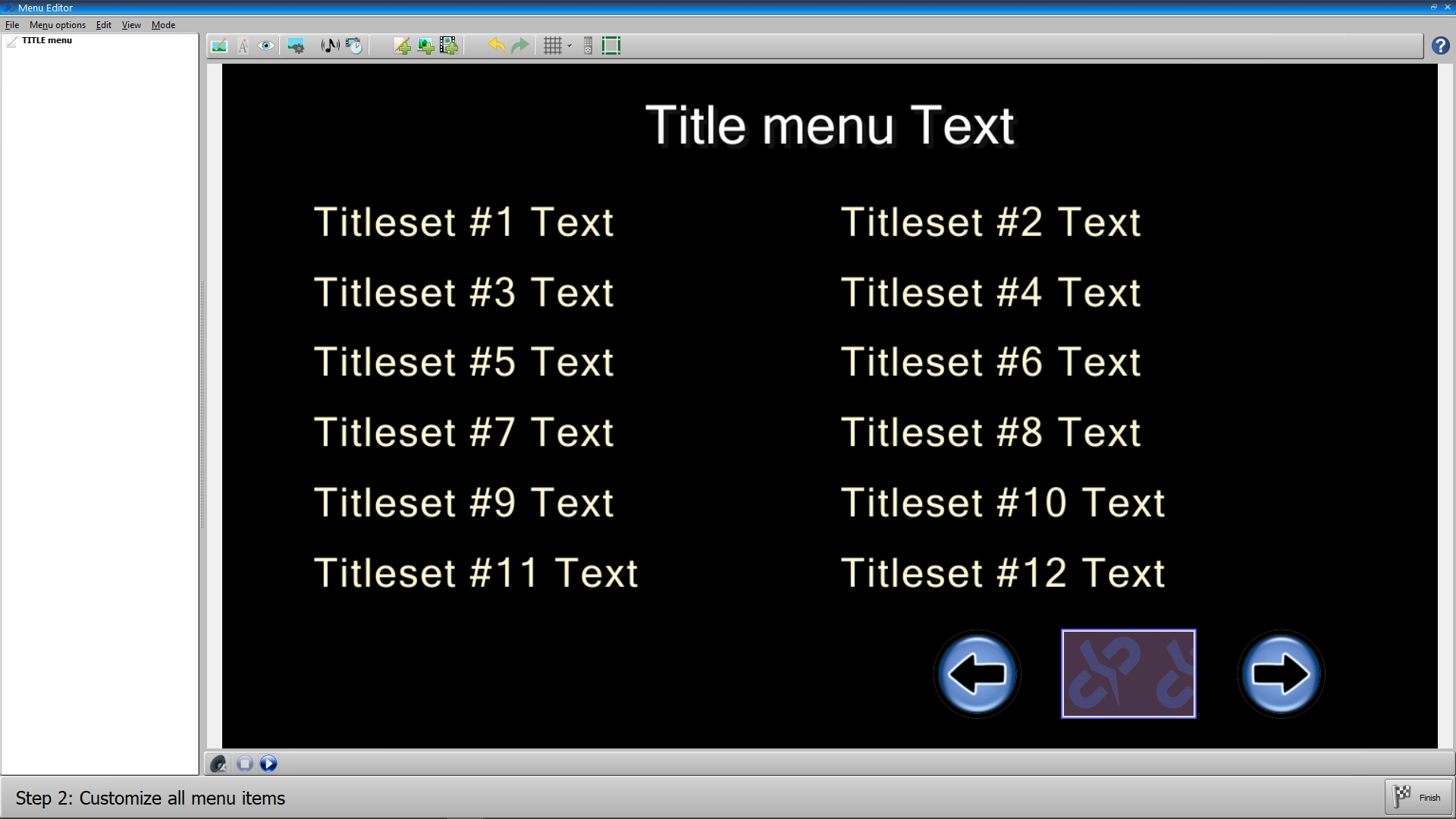

Then this is the end result:
Menu Page 1 see Screenshot 7
Menu Page 2 see Screesnhot 8

Screenshot 1
Screenshot 1
Screenshot 3
Screenshot 3
Screenshot 3
Screenshot 3
Screenshot 4
Screenshot 4
Screenshot 5
Screenshot 5
Screenshot 6
Screenshot 6
Screenshot 7
Screenshot 7
Screenshot 8
Screenshot 8
Screenshot 9
Screenshot 9

Has to do with the subtitle-font set from Arial to Microsoft Sans Serif.
If set to Arial then the intro-segment is skipped.
But if I set it to Microsoft Sans Serif it plays the intro-segment.
