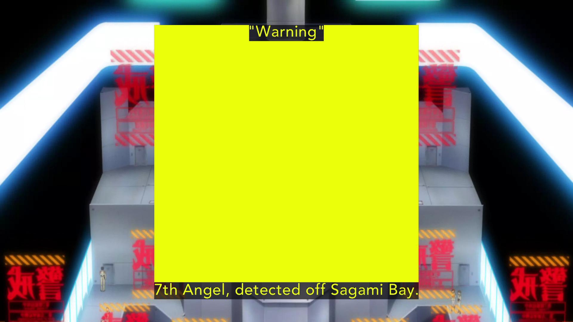

Both subtitles are displayed but there is a problem!
There is a big yellow (colour of subtitles) box that appears over both sets of subtitles. See attached
Image from converted video
file.
The "Warning" at the top is there for the full scene, the dialogue at the bottom is updated a few times.

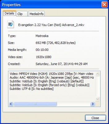

If I convert to an MKV file with soft subtitles (I can turn them off) I get the big yellow blob. For example this file...
looks just like the image in the above post when played with subtitles turned on. Big yellow block between the two subtitles.
