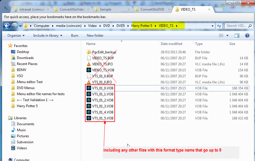

Echuir,
Can you try something for one of these disks where episodes load as one main file
From your DVD source copied file select all the vob files “VTS_01_0.VOB” and higher in number (see screenshot)
Copy only these files maybe goes up to 9 and put them in the new folder you created in your desktop, now in ConvertXtoVideo do not check "split by chapter"
now add the files you moved to your desktop do they load in a different way in the interface? Does it make it so you not longer need to split by chapter and merge again?
