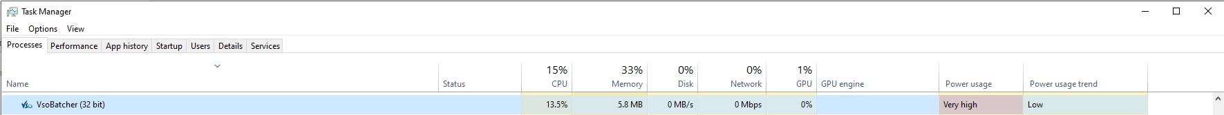

Posts: 5596
Re: ConvertXtoDVD 7 Batcher
I installed the batcher to see what is going on ;)
Ohh now I see what you mean, the process is running but nothing on the screen, zero nada :)
I will add these details to the bug report ;)
