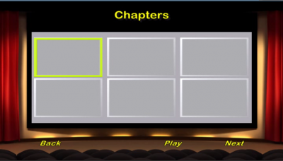

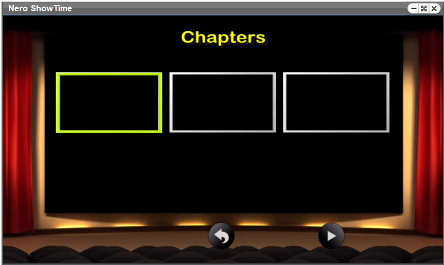

Bug in Menu Template-Cinema-navigation with text buttons(one main video).The chapters thumbnails are blank on the final output.
Blank Thumbnails
Blank Thumbnails

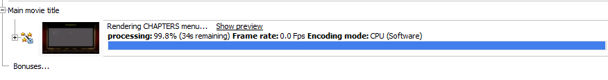

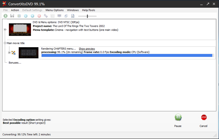

Bug in this version.programe takes 2 hours in rendering CHAPTERS menu...

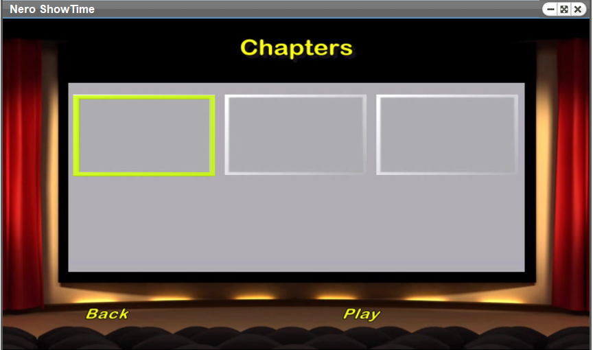

taking 2 hours in rendering menu

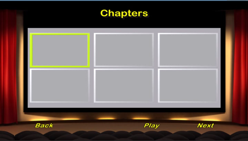

no thumbnail.PNG[/attachment]Done that ..did the clean install ..still not working.I am using GPlus(internal) skin.No thumbnalis on the final output of DVD.and taking two hours in rendering menu.

Same result.changed the skin to XP but still blank thumbnails
and changed the template also still blank thumbnails.

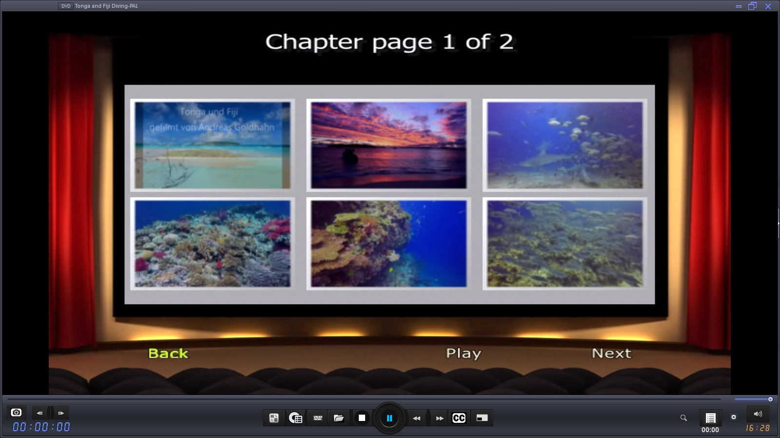

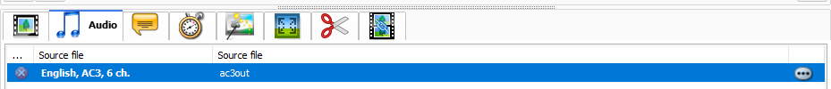

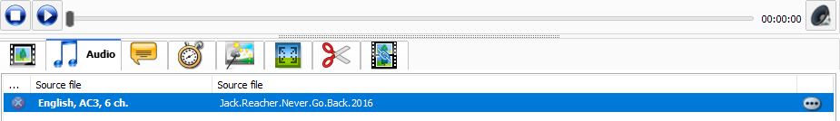

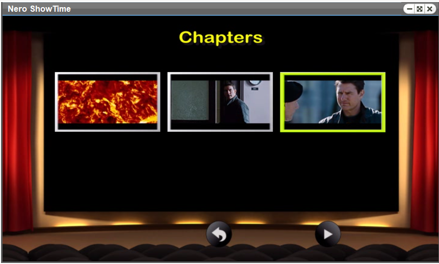

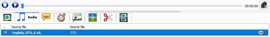

Ok.located the bug.Its nothing to do with skin or menu template.
When i select audio as AC3 within the software then the chapters are not blank on the final output.
but when i take the audio as DTS or AC3 [added externally] then the chapters are blank on the final output.
In AC3 ..audio which is being made by the software itself the chapters thumbnails are perfect on the final output irrespective of skin or menu template.
But in DTS audio or AC3 Audio (when added externally) the thumbnails formed are blank.
Pl.fix this bug.
The "2 hours rendering menu" and empty thumbnail issue are related to the same problem: ConvertX fail to seek in the source in the appropriate time.
It is very hard to seek accurately in a source file, especially if this source file is a composition of sources from several files, plus consideration of GOP (Group of Picture starting with an I-Frame) which make it even harder.
So, ConvertX does a seek a few seconds before the needed seek point, and decode to get the first valid picture at the requested time (or after).
But for some reason, this valid picture at the correct timestamp never come, nevertheless the entire source(s) file(s) are parsed and decoded.
This is what make the insane slowdown and the fact that the thumbnails are empty as after having parsed all the file without finding a good image, a black one is provided.
Obviously the code with composition of several files is broken in that behalf. It's been added to the buglist : http://bugs.vso-software.fr/view.php?id=13595
Stay tuned but I won't risk a time estimation for the fix as this is a very hard issue to solve, because touching this part usually break something elsewhere. So we are very careful with this.

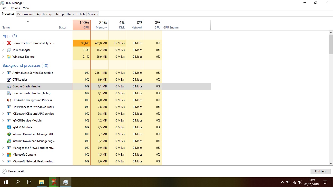

dear admin.
i am using a laptop with intel i3 6006u and vga nvidia 940mx 8Gb ram (but for the process my laptop is using integrated intel HD 520), and somehow lately when i am using CXD 7.0.0.64 it hogging my CPU. i don't recall having this problem before. when i am using it sometimes when i opening windows xplorer not responding (swirling pointer spinning around) for a while. can you fix this?
