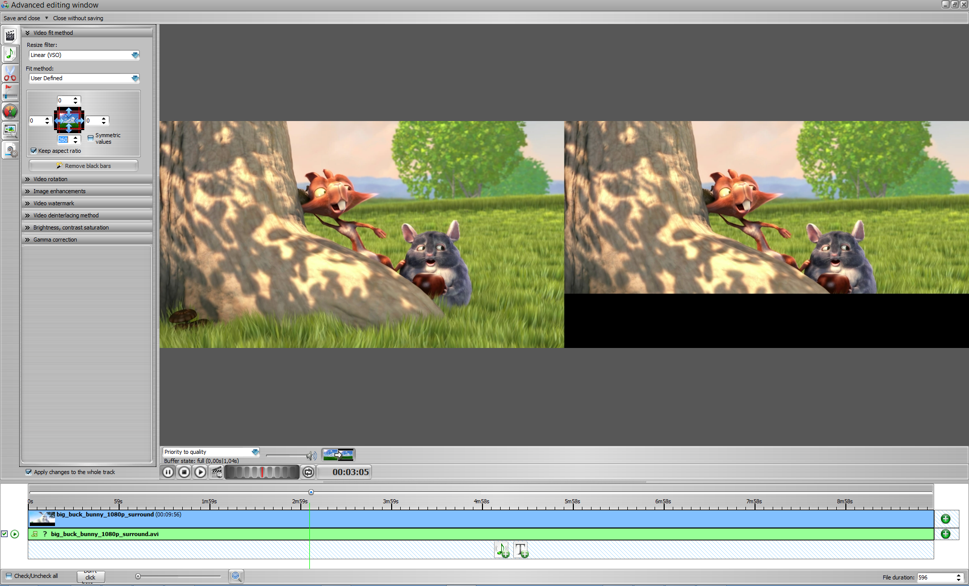

Re: Question about "cutting" movie keeping aspect ratio
This is the result you want, right?
If not, please give more details about your request...
mue.mat
Posts: 206
Post by mue.mat »
Yes, exactly! It should be like you show (just cutting, not changing the format of the movie).

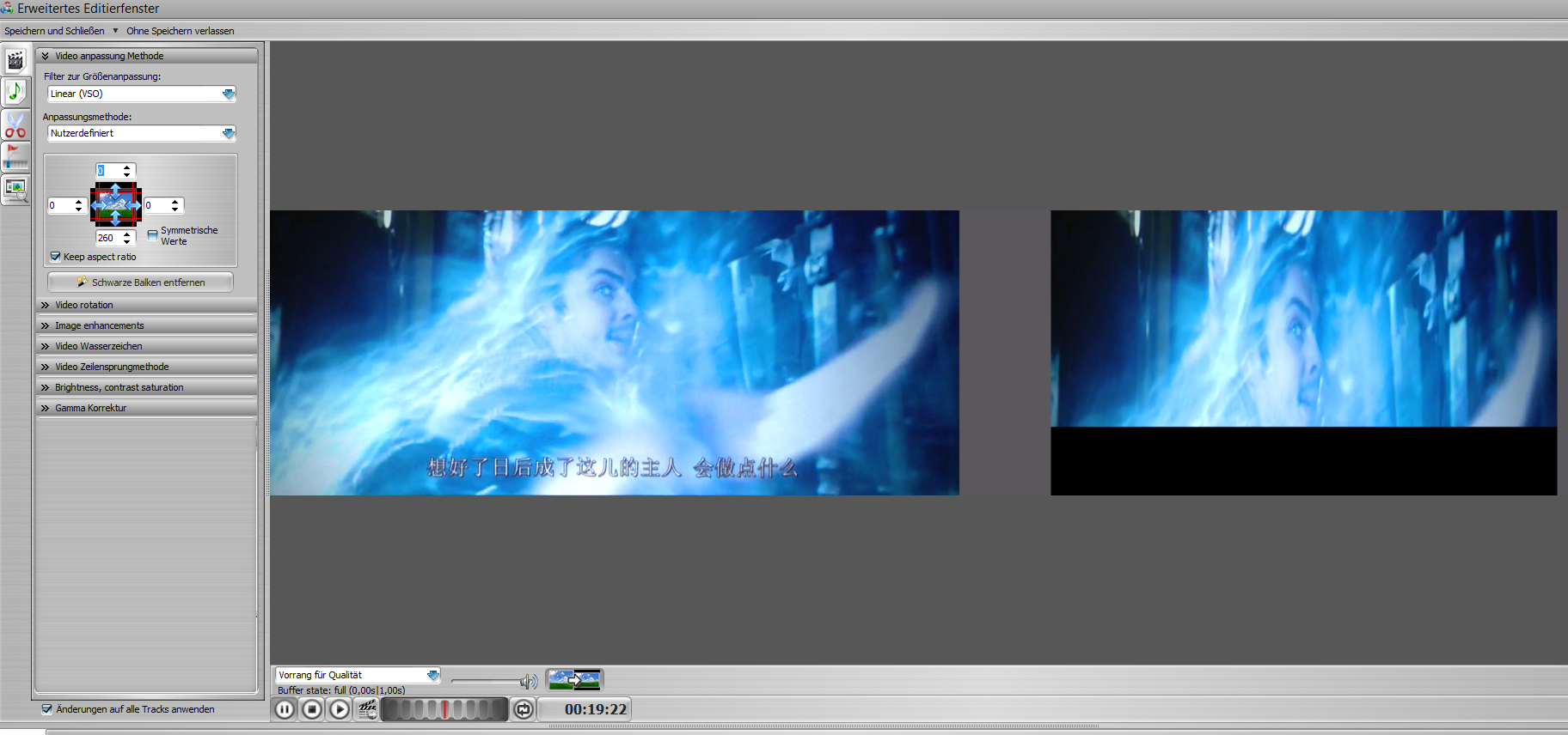

But at the moment, actual Beta Version 2.0.0.20 it looks like this: --> Attachment picture
Ok, I can reproduce your problem if I use a fixed resolution format (DVD, Blu-ray...)
