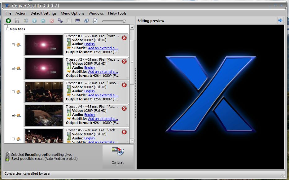

After using this happily for some time I've run into a problem. I have been creating Bluray discs of mp4 concerts (including the Lahti orchestra, JJ) and have been successful until now.
I've used the same settings as before but now after anything 15 - 30% it just stops with the message: It's not true - I'd set it going and was out of the room! ;o)
I've rebuilt the project more than once with no change and I used the Support Centre from the Help menu and it seemed to collect a lot of data then says it is sending it and to wait, and wait and wait; so I don't think that's working. I did however let it reinstall the program but it fell over again.

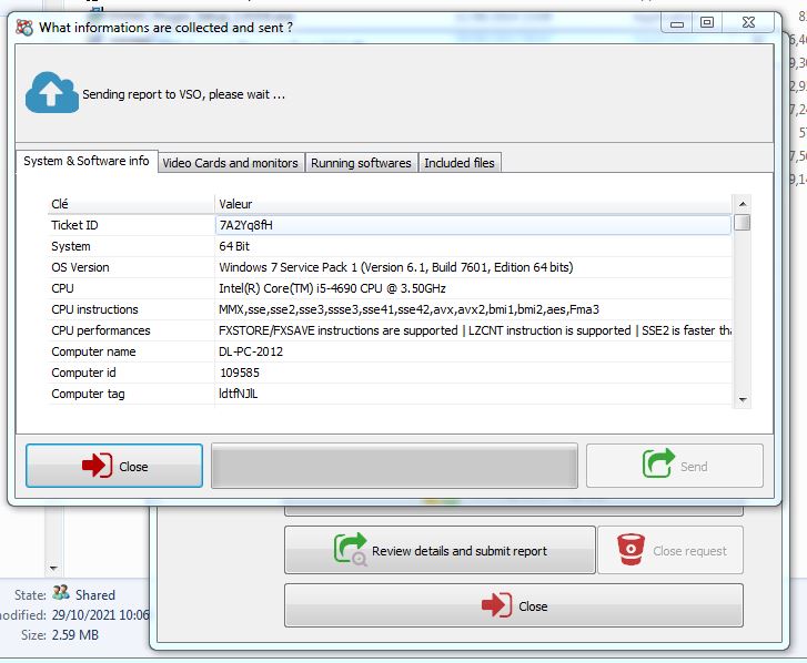

Many thanks, I'll do what I can to help but there seems to be a problem for me with your reporting tool. I have used it 4 or 5 times in the last few days but I always get this: It's still showing this 20 minutes after I submitted ...

Could it be your operating system? as the screenshot says windows 7. Microsoft support for win7 ended nearly 7 years ago, on January 13, 2015.
