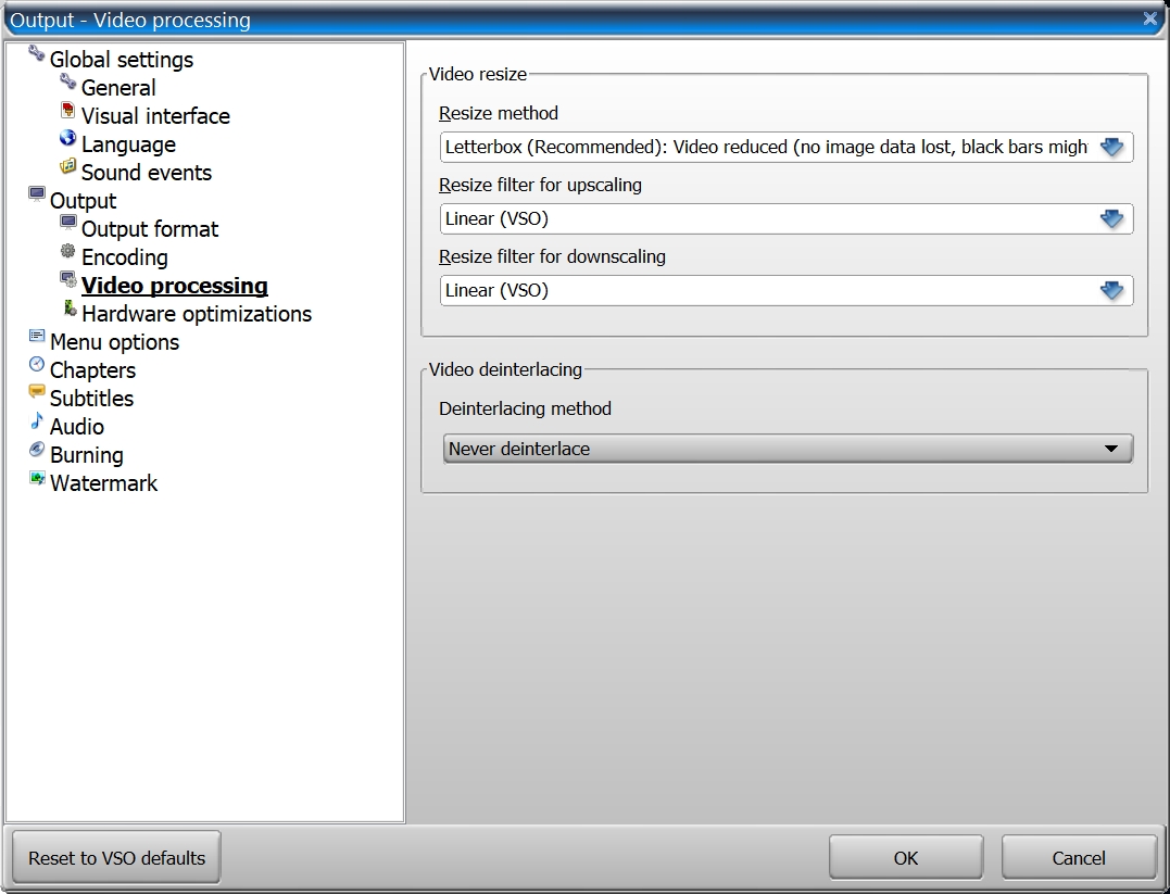

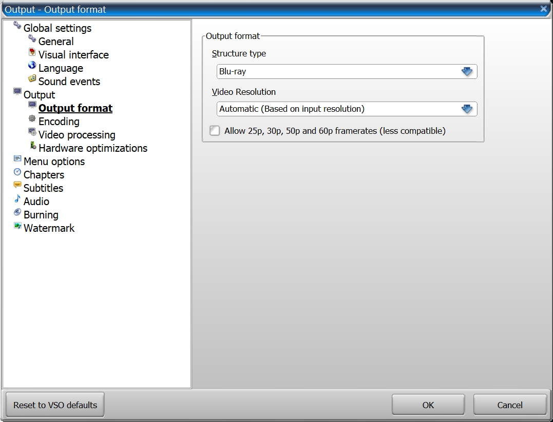

Here are my settings:

Well, I tried using @nemesh's "automatic" setting but actually the rest of his setup involved ENCODING. When I started the test the CPU needle went up near 100% and progress was slow. I'm not interested in any transcoding or re-compression at all.I want absolutely 100% original quality on the BluRay... exactly as I get using DVDFab BluRay Creator software to accomplish the result.
I want pure input-to-output if the format is suitable. And MP4 1080p MPEG-4 input is presumably suitable for a direct-copy. I've now re-tested using my original settings, except on a 32GB Win10 machine (instead of 16GB Win10 machine) and using a different MP4 file (still MP4 1080p MPEG-4). I also changed the output from BD25 to DVD-9 (still BluRay format, so this is acutally "BD9" suitable for using a DVD-DL media to hold BDMV output).
No change. Still fails, this time at about 59%. Log still shows "raw copy" for both audio and video which is what I'm shooting for. Progress gauge moves pretty fast (fails after only 2 minutes converting) and CPU usage is only very modest, not 100% like when encoding.

You are using a mkv and NOT a Blu-Ray structure.
So the settings you are using do NOT apply.
Extract the .iso file I send you.
That is Blu-Ray structure and then you use: 'Try to copy only if source is compliant'
