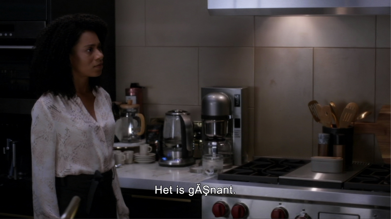

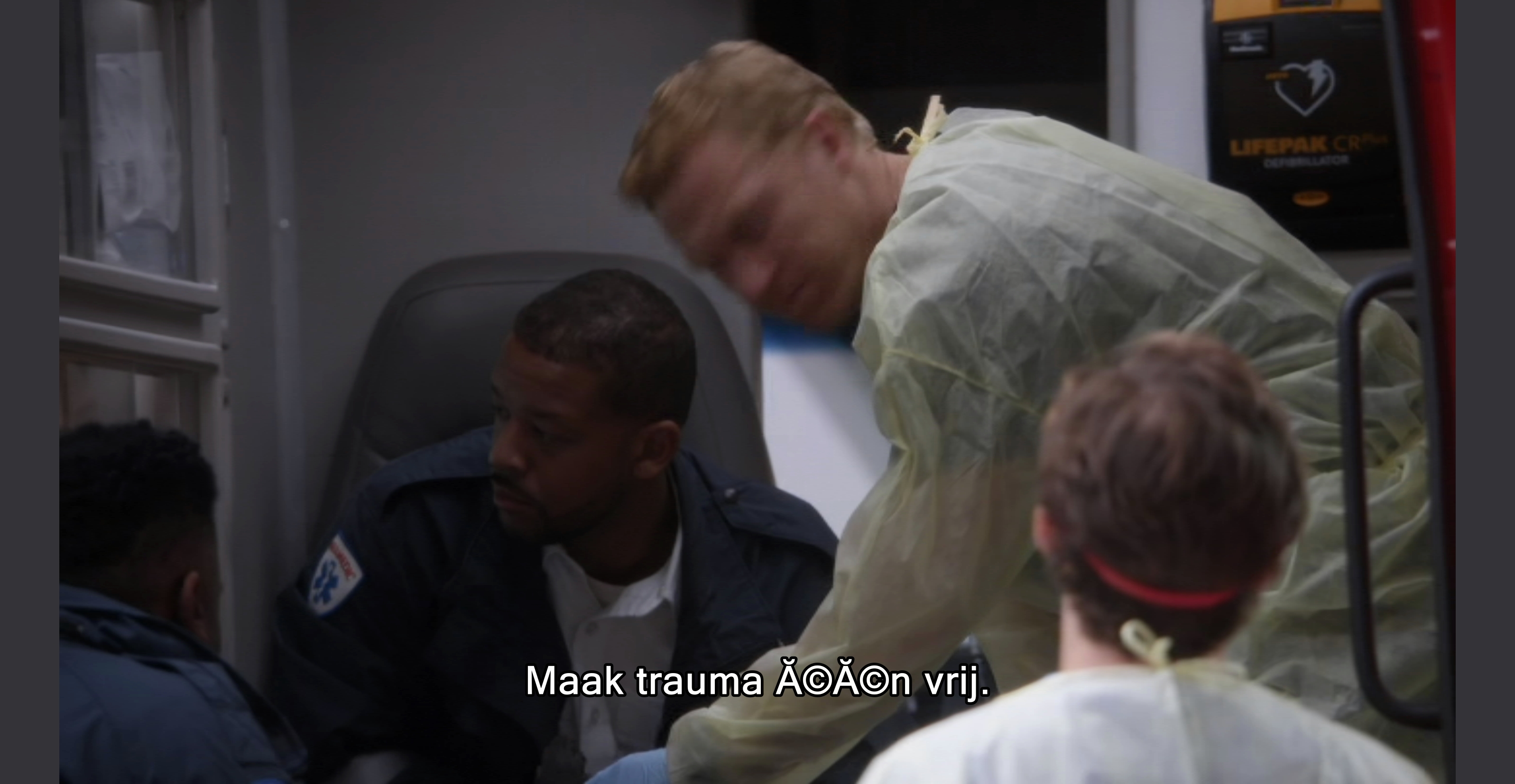

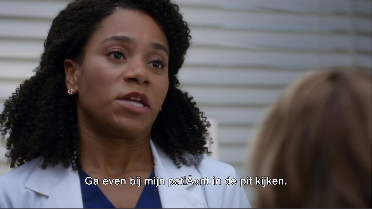

ConvertxToDVD converts the several subtitle-character wrong.
Screenshot 1 should bw: één
Screenshot 3 should be: patiënt
Screenshot 4 should eb: gênant
Working from srt file.

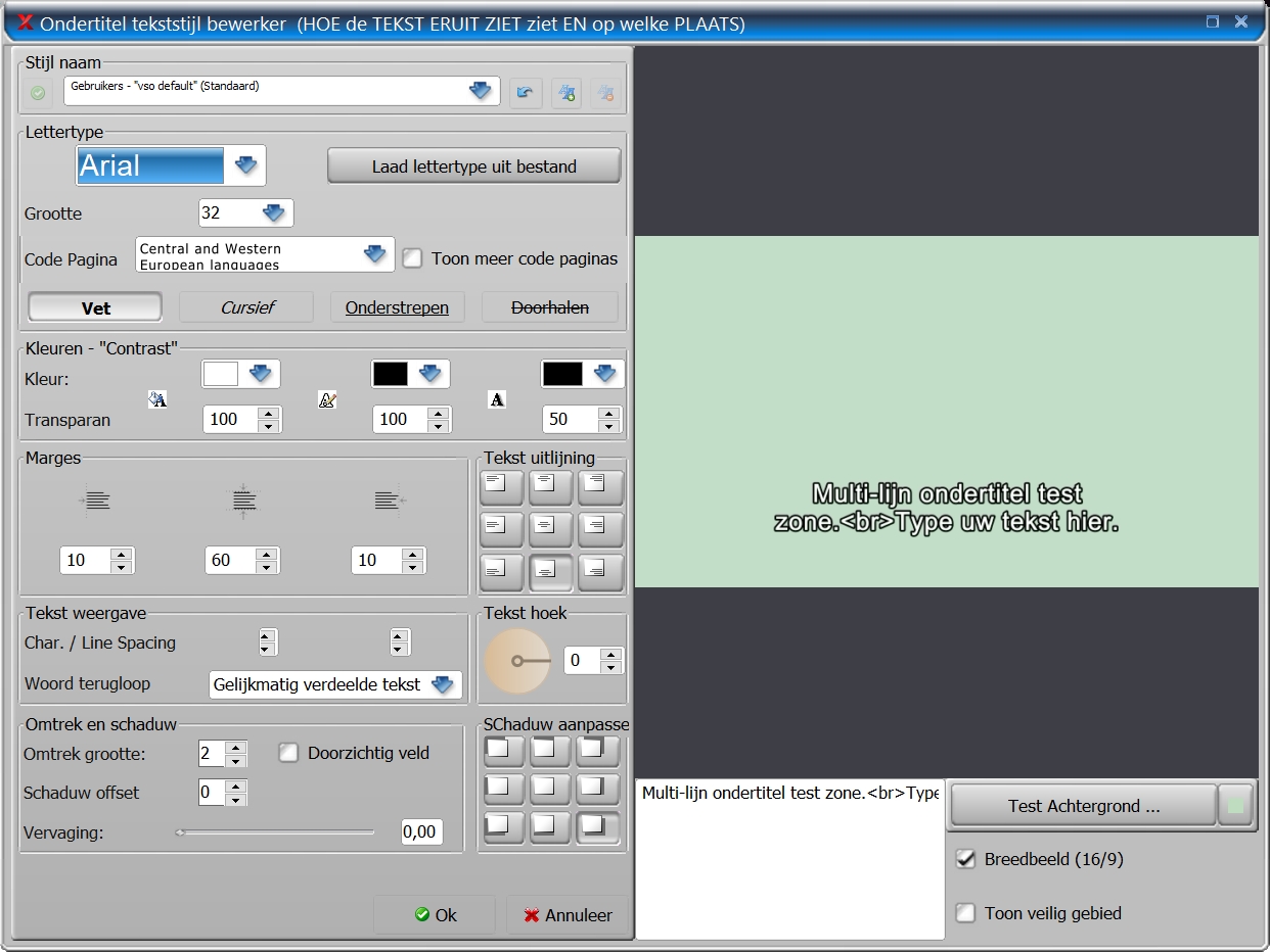

Font selected Arial, see screenshot 2
