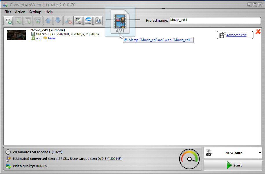

You can also in a open a the location where your video files are, select multiple files. Drag and move them over to ConvertXtoDVD window, as you hover over an already added video, notice the hint say that the files will now merge. Drop the files by letting go of the mouse, and notice how you have only 1 titleset (all the files were merged here).

1) Add a video file, then click on Advanced Edit. Under the preview window you will see a "green +" icon next to the 1st video stream listed. Click here to add the additional video files you want to merge.
This is an horizontal timeline. To add audio and subtitle streams to go along with the merged videos add them underneath the corresponding video streams 2) You can also add all your video files and then select all of them and right click and select "merge all selected titles" 3) You can also drag and drop videos on top of a file already loaded in the main interface
