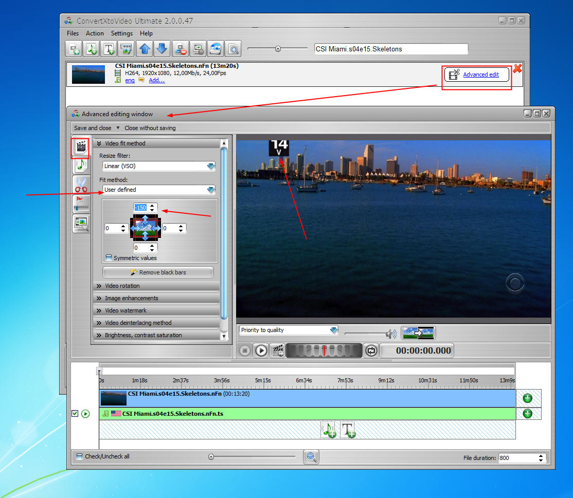

You want to click on the advanced edit button once you've loaded your video file to convert.
In the Advanced editing window you want to click on the Video fit method and there change the fit method to "user defined" or "user defined (keep aspect ratio kept)".
in my example you can see that -150 is not enough to crop out the logo in the upper left hand corner. I will also want to crop possible the left and write as well in order the keep the right aspect ratio.

Thanks for the answer, but I am afraid I was not clear enough.
Lets take a movie, select a profile and the main screen is saying: H264, 1280x720, 5,33Mb/s, 23,98Fps. And that's ok.
Using "Advanced edit", pressing "Remove black bars" detect 7 pixels up and down. Save and close
Now the main screen is saying: H264, 1280x706, 5,22Mb/s, 23,98Fps. Effectively slicing 7 pixels top and bottom. Still ok.
Using your method (which is what I was doing), selecting "Fit method: User defined" and selecting -90 for top and bottom border. Save and close.
Now the main screen is saying: H264, 1280x720, 5,33Mb/s, 23,98Fps. In fact the image will be 1280x540 but stretched to 1280x720. Not what I want.
As a final exemple,the same base movie...
Adjusting value to -90 top and bottom, save and close.
The manual adjustment was NOT kept for the final size, it shoud have been 1280x540, the result I am looking for.
And my question was: if it is not a bug, what should I do from that point?
