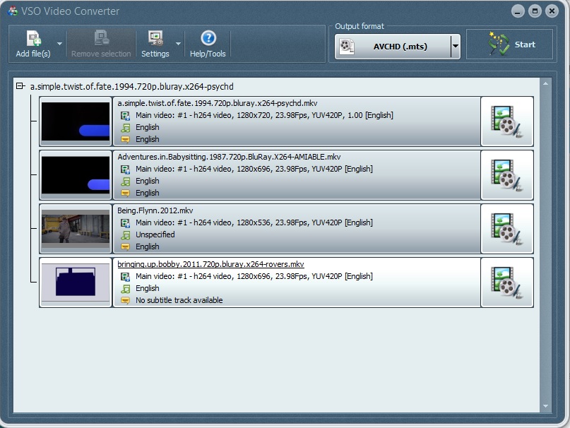

I understand what you are saying,that the individual files will be treated as independent. So why then do they appear in the tree as indented under the first file? Is that just a mistake in the interface?
Look at the attachment I included to see an example of the behavior I'm describing.
These movies were added in a batch. They appear "linked" but should be independent. The tree should reflect their independence.

The "first file"/ top level node is only the project name and use the first added file name as default.
Maybe should i use "my project" as default but that will result by replacing previous converted projects because this project name is used as output file path for single files (avi, mkv, mp4...) and used as title in DVD menus.
Edit: you can change the project name (and output path) by using "F2" key...
