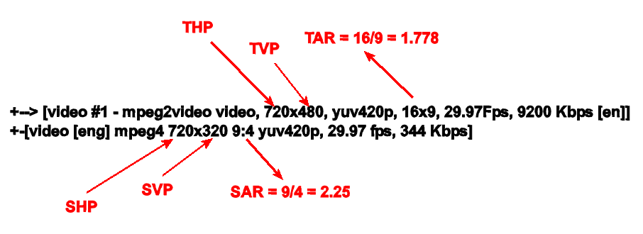

Note 1: The simplest way to determine values of those last six variables is illustrated in the attached image below. Start the conversion, pause it after a few seconds, open the conversion log, find lines similar to those shown in the image, determine values as illustrated, then either resume conversion if no changes are needed or cancel if you want to make changes before final conversion.
