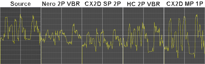

A Comparison of Results with Different Encoders
(Note: The images for referenced figures are at the end of this post. You can open a second tab in your browser and scroll it to the figures to view them without losing your place in the discussion.)

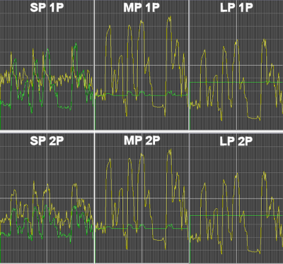

Fig. 1 compares the distribution of bitrate over a 2 minute segment of several conversions to a DVD5 target with that of the source. Time varies along the horizontal axis and each vertical division represents a 1000 kb/s bitrate change for the conversions but only 800 kb/s for the source -- the reason for the difference is not important to this discussion.
The source is a 20 minute clip taken from a high quality DL commercial DVD and added 6 times to get a 120 minute project. Using a 20 minute clip in this way allows keeping content constant while varying project length, in order to study its effect, by varying the number of times the clip is added to a project.
We can assume that every effort was made to provide an optimum presentation on the original DVD. So one way to evaluate a conversion of the source is to compare how well the shape of the converted result emulates that of the source. Comparing actual bitrates is not valid because the source was taken from a DL DVD so its bitrates would be higher than a conversion to DVD5.
In the figure:
1P = 1 pass conversion
2P = 2 pass conversion
Nero = the Nero Vision program
HC = the highly regarded HC encoder as implemented in the AVStoDVD program
CX2D = the ConvertXtoDVD program
Conversions in the figure are arranged from left to right in order of how well the converted distribution appears to emulate that of the source. The one that does best is the CX2D 1P CQ encode on the right. Note that it delineates complex scenes with high bitrates and simple ones with low bitrates just as the source does, and the relative complexity of scenes, as indicated by bitrate, is much the same.
It will surprise some that CX2D 2P resembles a traditional VBR encode more than CQ. That is because that conversion filled the DVD so a CQ encode could not be done, more about this later.
These results seem to substantiate the statement above that “A very good VBR encoder can achieve more consistent quality from scene to scene with multiple encoding passes which refine the bitrate distribution among different scenes. But even 5 or 6 passes will only approach constant quality for all scenes.”
The question in many minds must now be which is better, the HC 2P VBR or the CX2D MP 1P CQ conversion. One cannot make an accurate judgment from bitrate values alone because one encoder might be more efficient than another in the way it uses bitrate resources. My own limited comparisons of the two gives a slight edge to CX2D for the more complex scenes. They seem to be very close in the simple scenes with HC maybe a little better. That is typical of comparisons between CQ and VBR conversions though, because VBR usually provides more bitrate in simple scenes but less in the complex ones because of the size constraint discussed above. A comparison of partial frame captures is presented in http://forums.vso-software.fr/post54205.html#p54205 for the last complex scene on the right so you can form your own opinion. And a user that stirred up quite a controversy, finally decided that CX2D was best when the right settings were used -- see http://forums.vso-software.fr/post56139.html#p56139.

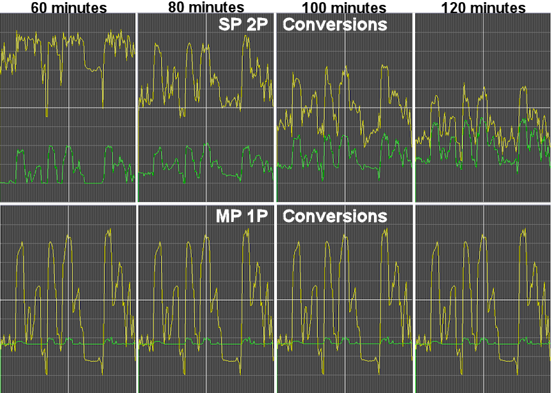

Fig. 2 shows how project length affects conversions. Both bitrate and Q are shown there with the vertical scale for Q varying from 0 to 10. Remember that Q (shown in green color) can be taken as a measure of quality with lower values indicating better quality.
Note that the plots for MP 1P are all the same because none of those conversions fill the DVD. The Q plots in them are not exactly constant, there are small peaks at the most complex scenes so CX2D has not done a pure CQ conversion. It cannot because DVD standards impose a maximum bitrate that can be used on a DVD that standalone players can be designed to play correctly. We still refer to conversions of that type as CQ though even though they are not pure CQ.
(A pure CQ encode would require trial and error conversions to find the minimum Q that would not cause bitrate to exceed the max allowed and would not exceed the size of the DVD. That would normally require a higher Q than used by CX2D which would cause overall quality to be less than with CX2D’s modified method.)
Now look at the plots for SP 2P at 60 minutes. That conversion did not fill the DVD either so it is a CQ conversion in the same manner, although not as apparent because it uses a lower Q value of 1 and Q has to rise to the same levels as for MP 1P for the complex scenes.
(Higher values of Q indicate that more bitrate was needed to maintain constant Q but could not be applied.)
We can compare bitrate and Q directly here because the same encoder was used for all conversions. Extensive analysis of converted results confirms this.
So, at 60 minutes, the SP 2P conversion is clearly better than one with MP 1P in simple scenes, but there is little, if any, difference in complex ones. But look at what happens with longer projects where SP 2P fills the DVD and an average bitrate must be imposed to force converted size to fit the DVD. Q begins to rise for all scenes as project length increases. For 120 minute conversions, it is about 45% higher for SP 2P than MP 1P in complex scenes and only about 12 % lower in simple ones. So one would expect MP 1P to give better quality overall at 120 minutes, and thorough examination of frame captures combined with careful viewing of playback confirms that.
One must conclude then that the best choice of encoding options for a particular source depends on project length. Note that converted size also depends on project length and the choice of encoding option
These plots show the progression from a CQ encode to VBR for SP 2P as project length increases. Since the overall quality of those encodes, compared with MP 1P, drops for longer projects, one must also conclude that using SP 2P for most projects, as proposed by some users, is not wise.

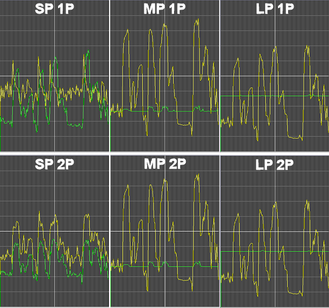

Fig. 3 compares 1 and 2 pass conversions at 120 minutes.
The difference between 1 and 2 pass for MP and LP is insignificant because neither fills the DVD so a CQ encode is done. Multipass cannot change anything that is constant whether CBR or CQ. Even in the complex scenes where CQ is not exactly constant, there is little room for bitrate improvement because the bitrate there is restricted by DVD standards. The only place a potentially significant difference is found is in transitions between scenes, but they pass so fast that they are inconsequential. So anyone that tells you that 2 pass is better when a conversion does not fill the DVD has a vivid imagination.
Now compare the SP 1P conversion with others in that figure. The SP 1P conversion is clearly bad in complex scenes because it has filled the DVD and is no longer a CQ encode, but is still the best in simple ones. SP 2P is better than that in complex scenes but worse in simple ones, but we have already established that MP 1P is better overall than SP 2P so the 2 pass option is a waste of time in this case. So we are faced with a compromise in deciding which option is best.
Note that the LP 1P conversion is very nearly a pure CQ encode but doesn't give results as good as MP 1P. So that figure illustrates that CX2D can give better results than a program that does a pure CQ encode.

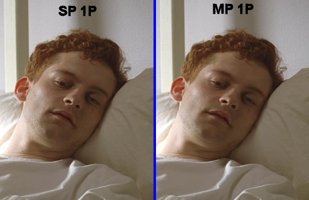

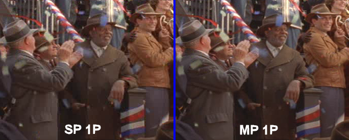

Fig. 4 and 5 present worst case partial frame captures to help you decide. Remember that a frame capture represents what is actually converted and written on your DVD for every pixel, it is not enhanced as usually done when playing the conversion on your computer with a software player or when played on your TV through a standalone player.
Download those figures, load them in a viewer or graphics editor and zoom them to about 300 % where individual pixels are apparent to see differences better.
You should find big differences for complex scenes and less of a difference in simple ones. Those images also give a clue about how the different encoding options work.
Look for differences in sharpness of detail in the complex scene in faces, clothing and the colored tape around the stair rail and the post. You will find what appears to be the beginning of block type pixilation with SP 1P in areas where there is little variation in visual properties like the man‘s gray pants or the coats and hats. It really isn’t as bad as it may seem at first glance. In an editor that has a tool that shows visual properties for individual pixels, you will find that those properties actually vary within what appears to be a block of equal properties, the biggest block I found, in a quick examination, with the exact same properties is 3 x 3 pixels. So the encoder has done the best it can do under the circumstances but the result is not good when viewed during playback.
There may be little difference at first glance in the simple scene comparison. But a close look at things like the texture of wall paint, edges of the vertical post and individual strands of hair shows a little less detail for MP 1P, but the face, the most important part of the scene for most people, is fine unless one is very critical. The result can best be described as a softening of the scene. Many people that have no experience with video conversion and therefore no prejudices or biases either don’t notice a difference during playback or, believe it or not, actually prefer the softer look of the MP 1P conversion for simple scenes.
Note again that Fig. 4 and 5 represent worst cases, they are for the specific encoding options and projects shown in the titles. But they can be used to get an idea of what to expect in other cases, refer to the discussion above of Fig 2 and 3 to get an idea of what can happen.
MP 1P should be the clear winner here if one keeps an open mind. So a CQ conversion that did not fill a DVD is better than a non-CQ VBR conversion that did fill the DVD, at least in this case. The same will be true in most cases as shown by many tests discussed in the References below and opinions of unbiased people watching conversions.
And, because the only noticeable difference between SP 1P and MP 1P when both do not fill the DVD, is a slight reduction in quality with MP 1P in simple scenes which many do not object to or even like better, one can conclude that not much is lost, if any, if the MP option is chosen when in doubt about whether SP will fill the DVD or not.

Why the Difference in Complex and Simple Scenes?
What is going on? There is little difference in the simple scene of Fig. 5, SP 1P looks only slightly better despite applying more than 4 times as much bitrate as MP 1P. But there are big differences in the complex scene of Fig. 4. MP 1P is much better there even though it applied only a little more than 2 times as much bitrate.
That points to the conclusion that quality in a CQ encode is not determined by bitrate alone, and therefore bigger converted size does not guarantee quality. One might also conclude that the SP option applies more bitrate to simple scenes than is necessary if you agree that MP does a pretty good job.
This behavior, which seems odd to users not familiar with CQ, is due to the way Q is used by the encoder -- CX2D uses the open source ffmpeg encoder.
The encoder allows Q to range from 1 to 31. Every pixel in every frame, regardless of how complex the scenery is, is described in the best detail the encoder is capable of when Q = 1, it is the best quality the encoder is capable of. As Q rises above 1, the encoder begins to save bitrate resources in simple scenes by grouping together adjacent pixels that have similar visual characteristics. Those saved resources can then be applied in complex scenes to maintain their quality.
If Q = 2, you will rarely find more than 2 or 3 pixels grouped together and those grouped pixels/blocks are spread throughout the frame, rarely close to each other where it would be objectionable. The blocks naturally become bigger and closer together as Q increases but still not very objectionable as long as Q is less than about 5. You will start to see noticeable blocks when Q is above 5 in a scene, they will be objectionable for most people for Q more than about 10, very few people will like a conversion where Q rises above 15, and any conversion producing Q as high as 25 in any scene is virtually unwatchable.

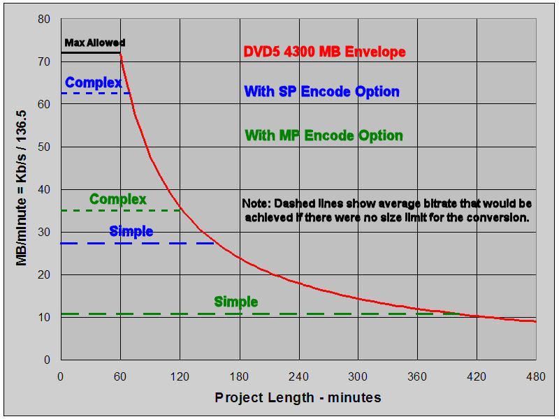

What Happens with Different Source Files?
We have learned that a CQ encode uses only as much bitrate as necessary to keep quality the same for all scenes. Less bitrate is needed for simple scenes than complex, so it is logical to expect that converted size of different sources will vary according to the average scene complexity.
Logs posted in the forum were surveyed to shed light on how much variation can be expected with typical sources. The results are in Fig. 6.
Only conversions that did not fill the DVD are shown because that gives a CQ encode. (The percent occupancy of the conversion is shown in your log. Because of the way CX2D works, occupancy less than 95 % usually indicates a CQ conversion while those above 95 % usually indicate a less desirable traditional VBR conversion.) Only those conversions with one audio stream, either stereo or 5.1 surround, and one or no subtitles are shown, because audio and subtitles require fixed bitrate resources so multiple ones reduce bitrate resources that could be used for better video quality. And there were not enough samples of LP conversions to include.
The bitrates shown on the vertical scale were obtained by simply dividing the converted size by project length. They can easily be converted to more conventional kb/s units if desired by using the conversion factor shown there.
Fig. 6 shows that
1. Converted size for SP can vary by more than a factor of 2 because of different scene complexity and by more than a factor of 3 for MP.
2. Project lengths that will not fill a DVD5 can vary by a factor of more than 2 for SP and more than 3 for MP.
3. The ratio of converted size for complex scenery is about 1.8 times higher with SP than MP. That ratio is about 2.5 for simple scenery, it s about 2.2 for average scene complexity. (This illustrates how converted size jumps in steps when the encoding option is changed, as mentioned earlier.)
Now we must conclude that the best choice of encoding options for a particular source depends not only on project length but also very much on average scene complexity in the source.
Remember that these are typical results. There are a few videos with average scenery even more complex than these and some even more simple.
Data in Fig. 6 is presented as actual numbers in http://forums.vso-software.fr/post71866.html#p71866 along with some more insight into what they indicate.

Fig. 1 - Encoder Comparison for 120 Minute Project
