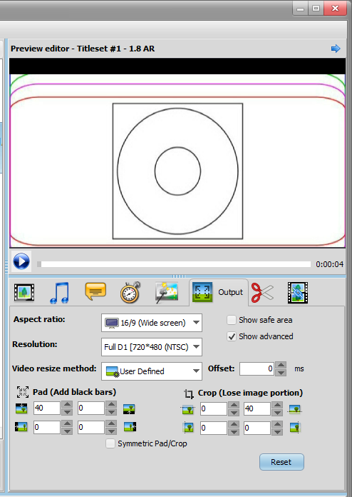

Suppose you have a video with a news crawl trailer near the bottom of the screen that you want to get rid of. You can crop the bottom of the screen to remove that part. That can be done in the video resize editor. The ConvertXtoDVD v5 editor is shown here but the one in other VSO programs is similar and requires the same steps.

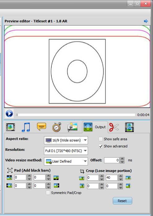

An example is shown in Image 1 that is not typical but serves to illustrate the procedure to use. Image 2 shows what it looks like after the trailer is cropped out. Notice the distortion of the square and circle there. Another step is needed to fix that distortion.

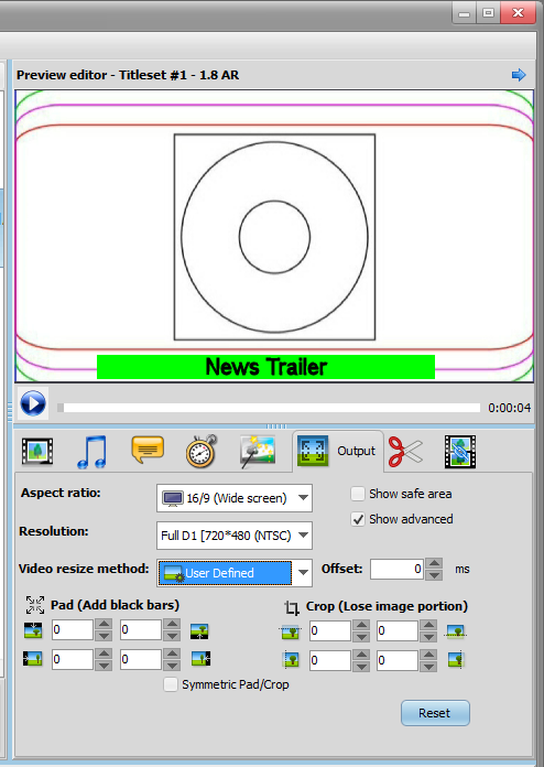

The simplest way is to pad the top by the same amount as that used to crop the bottom -- 40 pixels in this example. But that adds a black bar at the top as in image 3 which does not look good. A better approach is to split the padding equally between top and bottom, as if letterboxed, which produces two smaller black bars 20 pixels high and looks better.
If you don't want the black bar(s), you will have to crop the sides, again in order to prevent distortion. Cropping the sides will lose part of your picture naturally.
