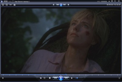

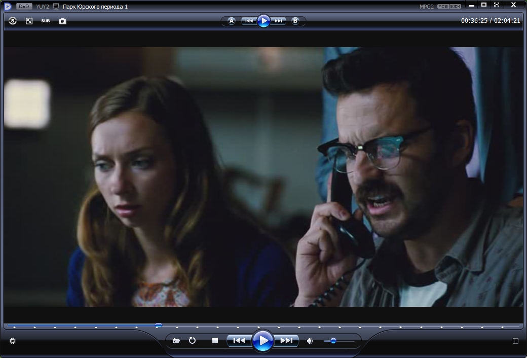

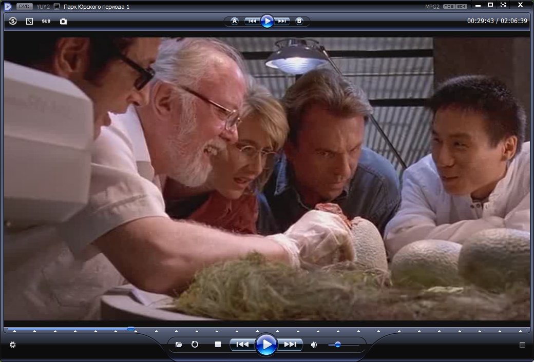

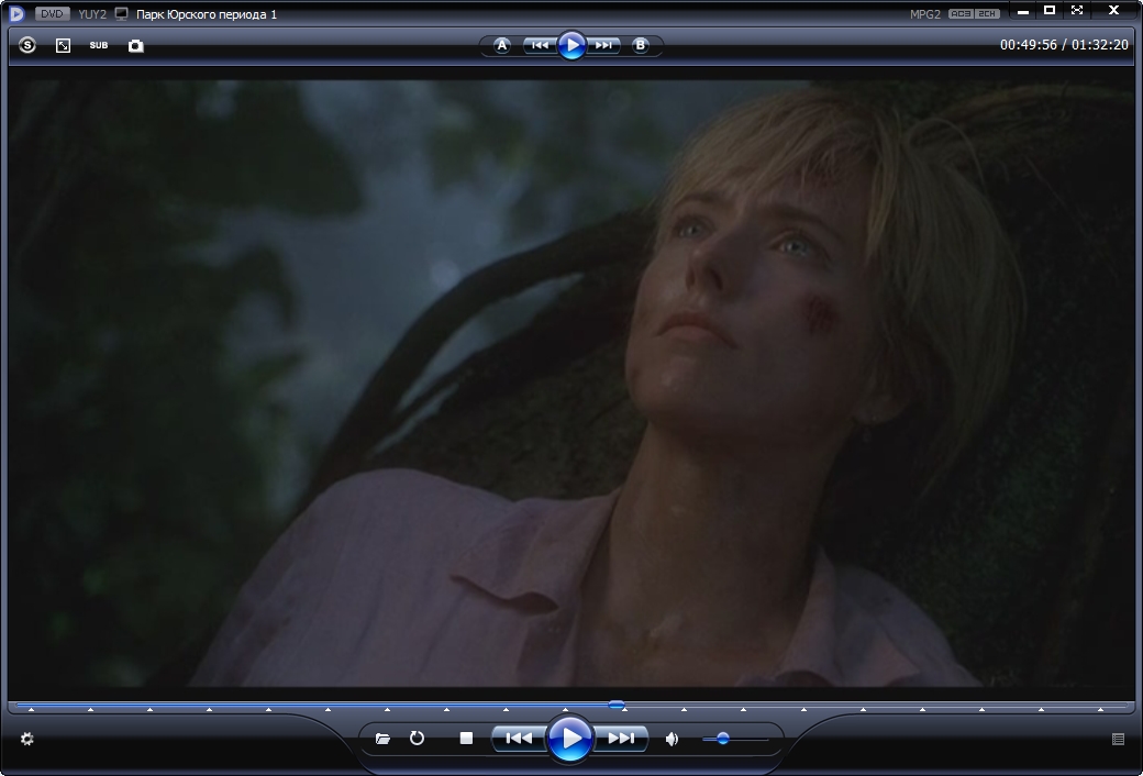

Here is an examples of may experiments. I always use SP-mode, 2-pass, bq-option and lanczos filter. Ofcourse there's some blocks in fast movement in several scenes but it's not very critical.
I must say that late 7.0.38 version is quite good. Provides better quality with low bps. It's a bad way to think that auto mode will bring you better quality instead of SP-mode.

I don't think you've got pixelated scenes because of low bps. Maybe it's all in upsacaling method of your TV.
is these screenshots quality good?
igor_lvk
Posts: 365
Re: CXD Conversions Look Pixelated with Low Bitrate???????
Post by igor_lvk »
You think that it's bad???
it depends on your source, but screenshots quality is not good
igor_lvk
Posts: 365
Post by igor_lvk »
deadlyshadow wrote:
Ofcourse it depends of the source, but on old TV 4x3 it looks very good.
