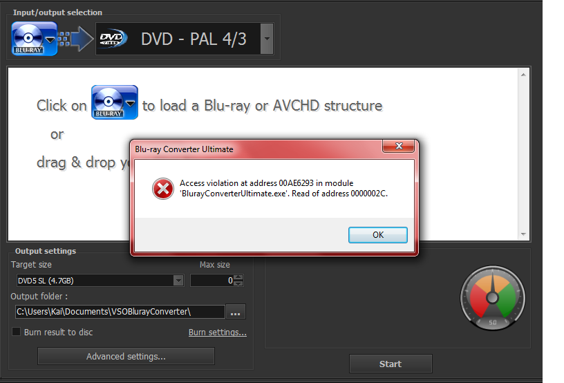

And one more item on the x64 system when I try to open the Advanced sttings tab:
As attachment of this post
Picture of access violation when opening Advanced settings tab

Postby cedric » Fri Nov 18, 2011 4:20 pm
I don't think the problem is related to x64 OS because I tried to reproduce on 3 Win7 x64 computers without "success".
The problem can be with NVidia card, will try to reproduce by considering this point.

There must be something wrong with the programmed code, I don't think it's the driver, because I found a solution maybe it is useful for your development. And I love this app that's why I post here.
As I said before the list index out of bounds still occur.
Now to the advanced settings tab. It now works but it was a hard work to find the solution by trying this and that...
OK, If anybody has the same problems with it, just: Click to load a Bluray or AVCHD structure
Then load from folder and select your movie. When the folder structure has loaded successfully
after all the Advanced setting tabs work.
Maybe this is useful for the developers.

Re: New VSO Blu-ray Converter Ultimate BETA version (1.4.0.5
Postby Claire » Mon Nov 21, 2011 12:46 pm
Are you saying that if you click on the "Advanced Settings" button before loading a video, you get the error?
Is this still happening?
The only way for you not to get the error is to load a video first then click on "Advanced Settings"?
Thanks for your help.

Postby KaiK » Mon Nov 21, 2011 4:57 pm
I am saying this before loading a movie, this error occurs.
And this error sill occurs.
Clicking the advanced settings tab first does not work at all.
I noticed something else. The list out of bounds error message pops up when 1 or 2 registry entries are missing. Does not matter which one. Your installer creates those entries in HKCU...
Can't you make it happen that the intalled exe creates those entries? Because the installer missed installing the proper entries. Just a suggestion. Just like, for example img burn. IMGBurn creates those entries when the application starts the very first time.
You must know I create installers by myself with Windows Installer Technology and I know what I am talking about.

Re: New VSO Blu-ray Converter Ultimate BETA version (1.4.0.6
Postby Claire » Fri Nov 25, 2011 4:18 pm
A new version has just been posted, can you tell me if you still get the error with it:
http://oasis.vso-software.fr/Beta/Blura ... .4.0.6.exe
Posts: 3824

Re: New VSO Blu-ray Converter Ultimate BETA version (1.4.0.8
Postby KaiK » Mon Dec 12, 2011 3:36 am
Sorry for my late reply. Was pretty busy.
Well, everthing seems to be working now. Will check out some more items.
Good work.
