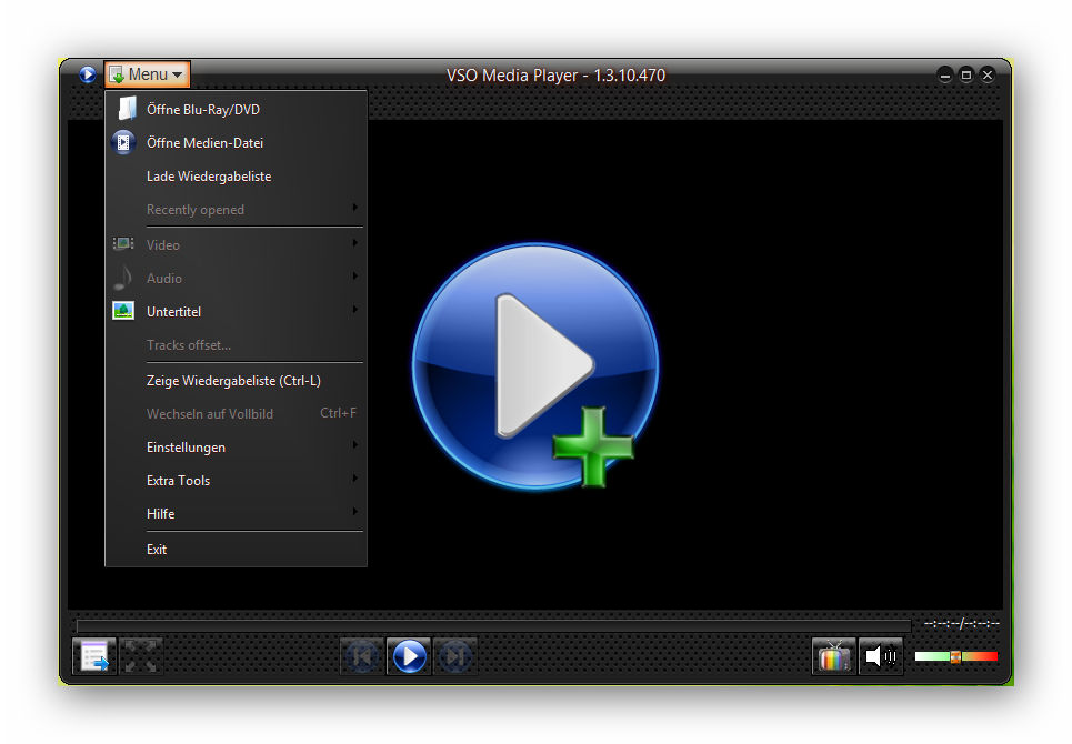

Postby saad » Sun Feb 02, 2014 5:46 am
I have a Windows 8.1 64-bit system with 3 user accounts all with Administrative rights. The system language is English (United States). When I opened your program for the first time from the user that I installed your program with, it chose English as it's default language. When I opened your program for the first time from User 2 & User 3, it opened with the Dutch language as default. I think there should be a way that your program should adapt the system language for all of the users.

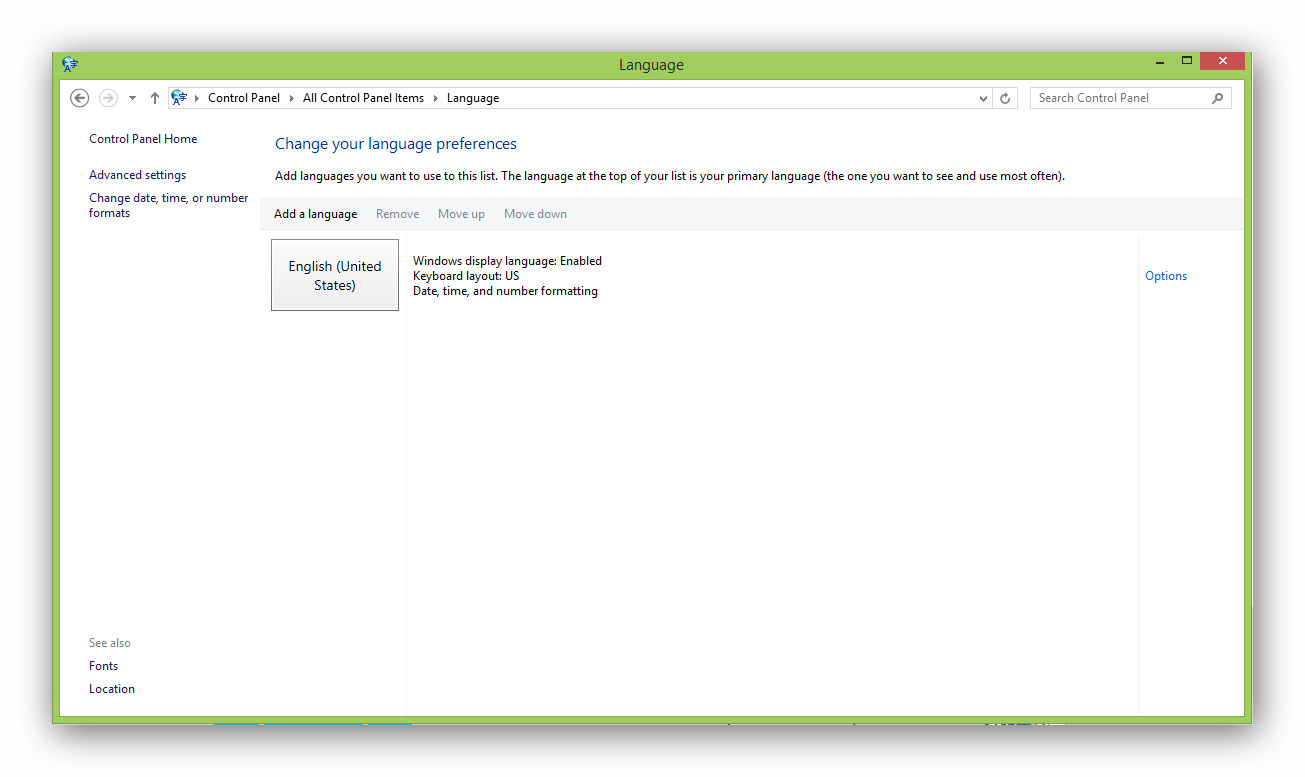

System language settings for user1, user 2 and user3.

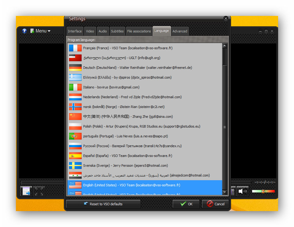

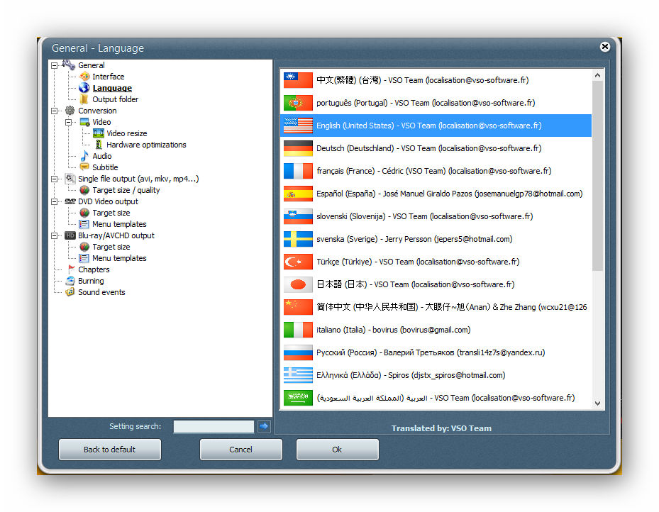

Postby saad » Fri Feb 07, 2014 8:02 pm
I just installed and tried your Video Converter. Everything is fine on all the user accounts.

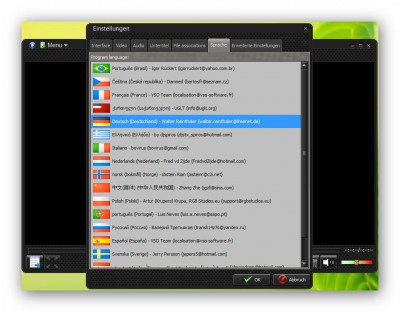

Please compare the language windows of both the programs:
Video Converter Language window
Media Player Language window
saad

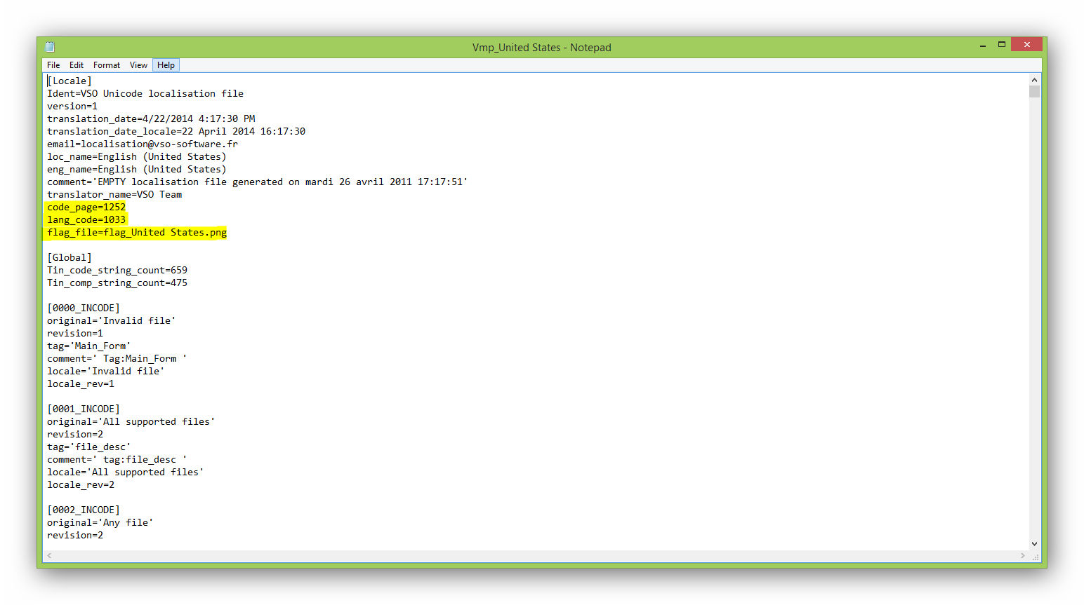

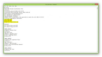

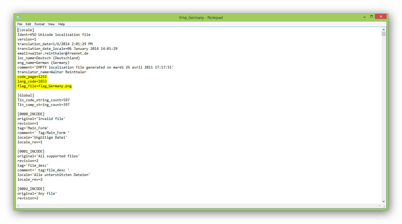

Postby saad » Wed Apr 23, 2014 8:19 pm
I just installed the latest version. The language issue is not fixed. I think there is some issue in the language file. Why code_page and lang_page are same in both the language files. Please look at the attached snapshots.
saad
Posts: 34
Joined: Thu Nov 06, 2008 2:30 am
Re: Problem with language!

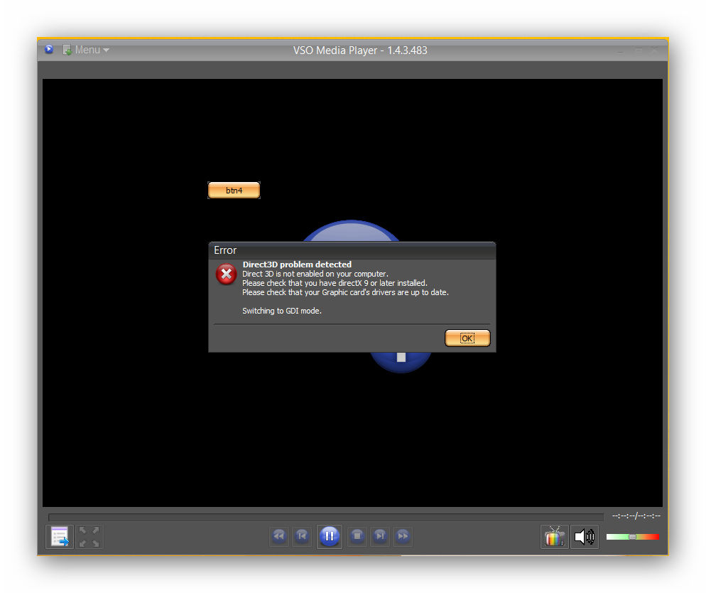

Postby saad » Thu Apr 24, 2014 9:11 am
Finally, the issue is resolved. Now, I'm having another issue. Please look at the attached snapshot.

Postby felicia » Thu Apr 24, 2014 10:13 am
Told you it was a quick one ;)
You can either roll back to latest published version or redownload the beta (I've removed the test button) and see what weird thing happens next ;)
