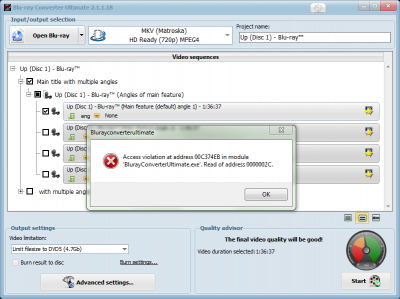

I have had this problem with version 1.4.0.8 and with version 2. Am now running the latest version (2.1.1.16) and still get the Access Violation error if I try to click the 'Advanced Settings' button, and also part way thru the conversion (Sometimes it is fairly quickly, other times it gets almost all the way to the end)
I am running Windows 7 SP1 x64 with AnyDVD . I haven't tried ripping the entire BluRay to disk first as doing that would not be acceptable anyway. I have tried disabling DEP for the program.

Hi MrFawlty,
Thank you for your helpfull screenshot...
Can you try with the last beta version I've just published (2.1.1.19) to check if your problem is fixed?
If you don't get the access violation, I think your problem can be with your graphic card drivers (can you check if a new verison is available?)
If you still have the access violation, can you uninstall the Elby low filter, reboot your computer then retry?
I'm waitingf for your feedback...
Thank you!
